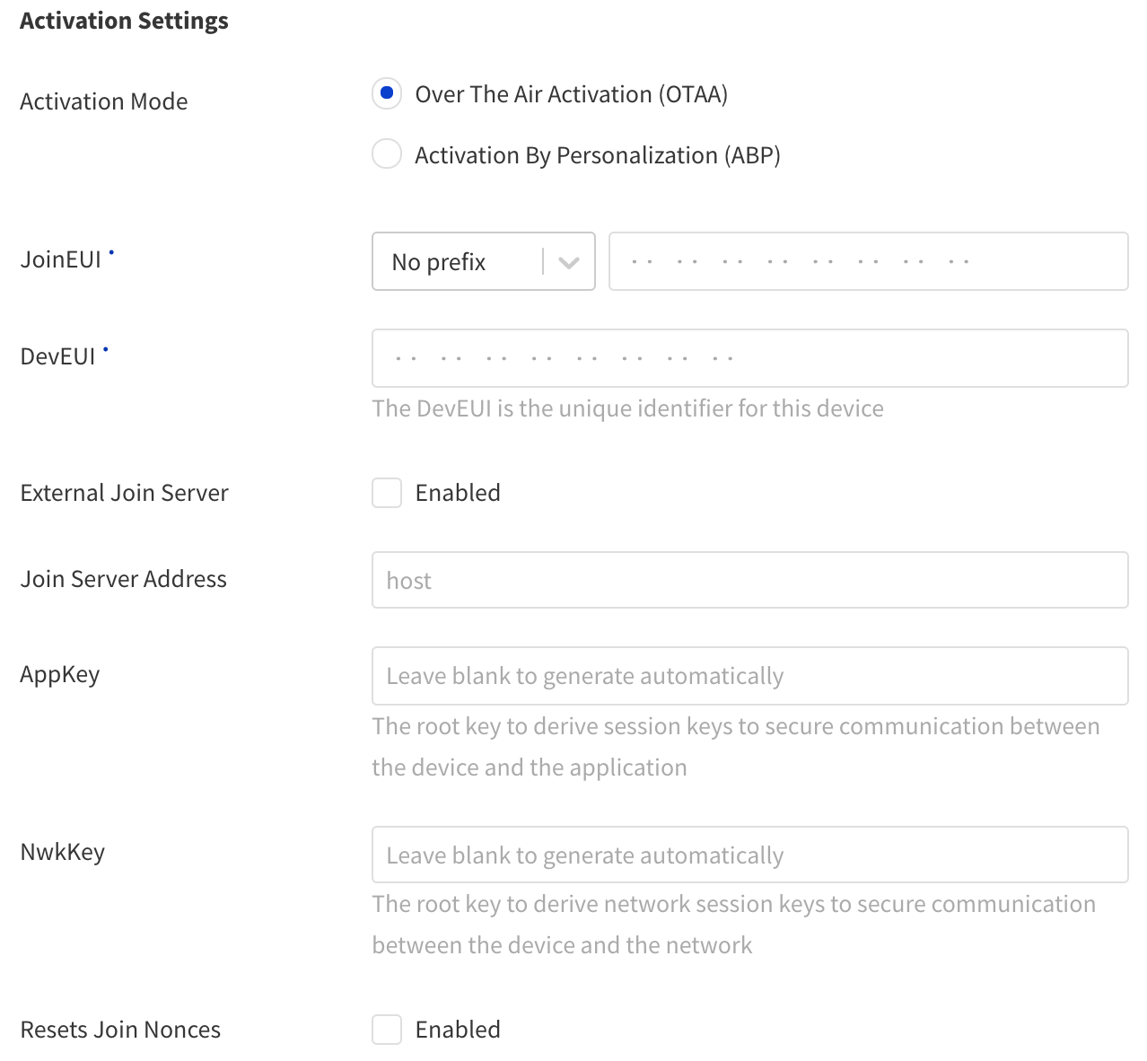

In V3, the LoRaWAN 1.1 terminology is used. For LoRaWAN 1.0.x devices, you need to enter the AppEUI in the field for JoinEUI, which in V3 is not in the application, but in the device settings.
As it’s mandatory: what did you fill in there? And any other configuration that you did not understand? (Leave the NwkKey blank for 1.0.x devices.)

-What is the definition of Reset join Nonces?

Note that it says “Resets Join Nonces”. So, I’d say it’s something that the Join Server may, or may not, do. That said, I’ve no idea.

LoRaWAN prohibits join nonce re-use, so a proper node has to keep track of values it has already used and not try to use them again, ever.
The ability to reset them server side would be for situations such as developing the part of the firmware that keeps track of that, or finding a bug in it, or loosing the EEPROM where the used value state is stored or something like that.
Hi and thanks, that solved that question, do you know how to within console to send a message to a joined device?
So “Resets Join Nonces: enabled” below could translate to “Join Nonce Security: disabled”?
And why is this option only available when not using “External Join Server”? (Below, all configuration after “External Join Server” is only enabled when that option is not checked.)
V3 Join Server settings
Because it would be the join server’s decision what to accept or not
