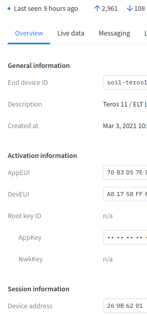

Hi, was currently testing 3 Class C end devices on the V3 stack. These have been operational for just over a month but lost the ability to join about 9 hours ago. Is anyone else experiencing this problem? Thank you.
Yes.

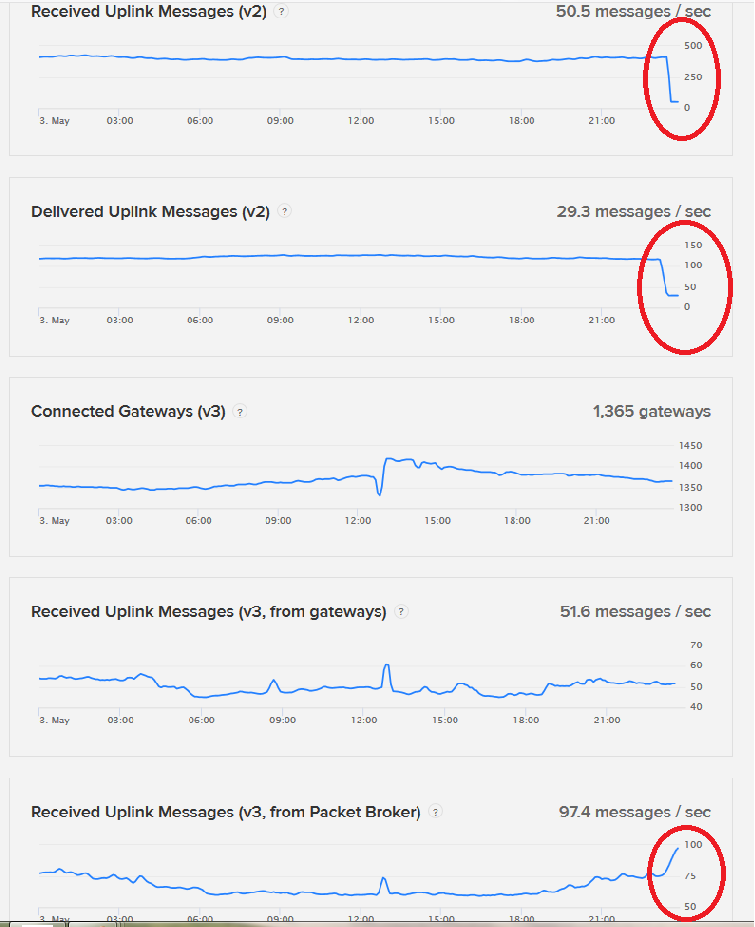

I’ve seen no brokered packet forwarding from V3 registered sensors via V2 gateways since around 23:50 1st May
On a variety of application, sensor and gateways
E.g.
Here’s 26.0b.62.01 not seen since 9 hours ago.

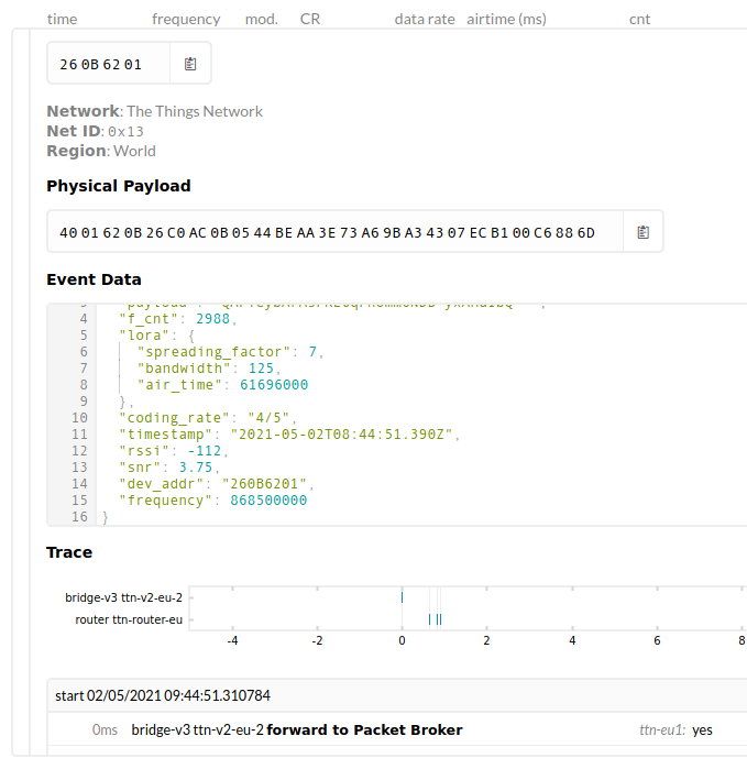

But here it is being passed through its local gateway.

Similiar problem here (close to Berlin).
All data from my V3-sensors is received via a V2 gateway and arrives in the console.
But then the data is not forwarded to V3 - the console says “router-ttn-router-eu drop reason: nobrokers”
The last transfer happened at 1:53 am local time today, that should be 23:53 pm UTC on may 1st.

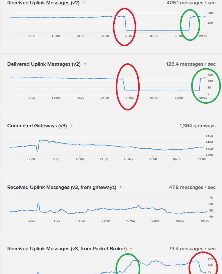

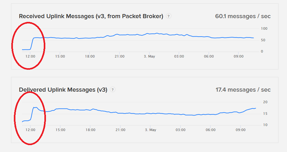

Just packing up for the night and happened to check status and see what may be the start (in last 30-40 mins) of another problem? Interesting that there is a corresponding ~30% uptick in V3 traffic around same time… no issues raised on Slack yet and no posts to forum for people with problems or asking for help so may be nothing…will look again in the morning!
Yep, there was a problem so anyone missing data overnight (EU time zone) can see why - now resolved per status message below
May 4, 2021
Resolved - This incident has been resolved.
May 4, 10:22 CEST
Update - Our metrics show that traffic is flowing again. We have re-enabled the MQTT API and are monitoring the system.
May 4, 10:01 CEST
Monitoring - We discovered that the router is the failing component at the beginning of the investigation. We recovered the router quite easily, but the handler crashed (similar to a previous outage) and took a while to recover.
We have temporarily disabled MQTT ingress and are monitoring the situation.
May 4, 09:28 CEST
Investigating - We are investigating an outage in the TTN V2 Cluster
May 4, 08:41 CEST
Interesting to see that as V2 traffic dropped there was corresponding uptick (and subsequent fall back on fix) in V3 traffic…
