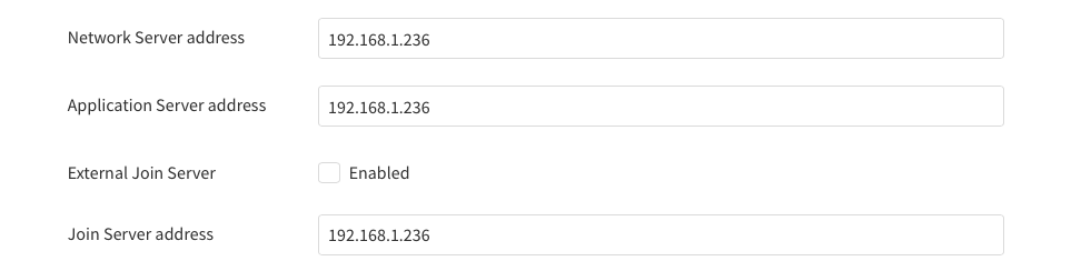

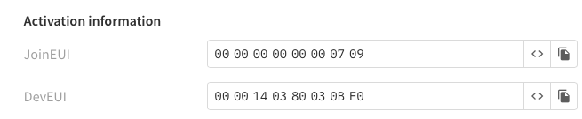

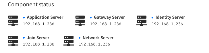

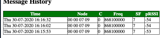

i add some screen of configuration.
Can u help me?
