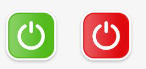

What logic do you recommend I use in my mobile application? I am using street light controllers in class C, but sometimes I do not receive the ACK that the light was actually turned on or off. My logic is to press the button and block it for a while until I receive the ACK, and if it does not arrive after 4 seconds, unlock and try again. Is there anything that can be modified in the TTN configuration?
