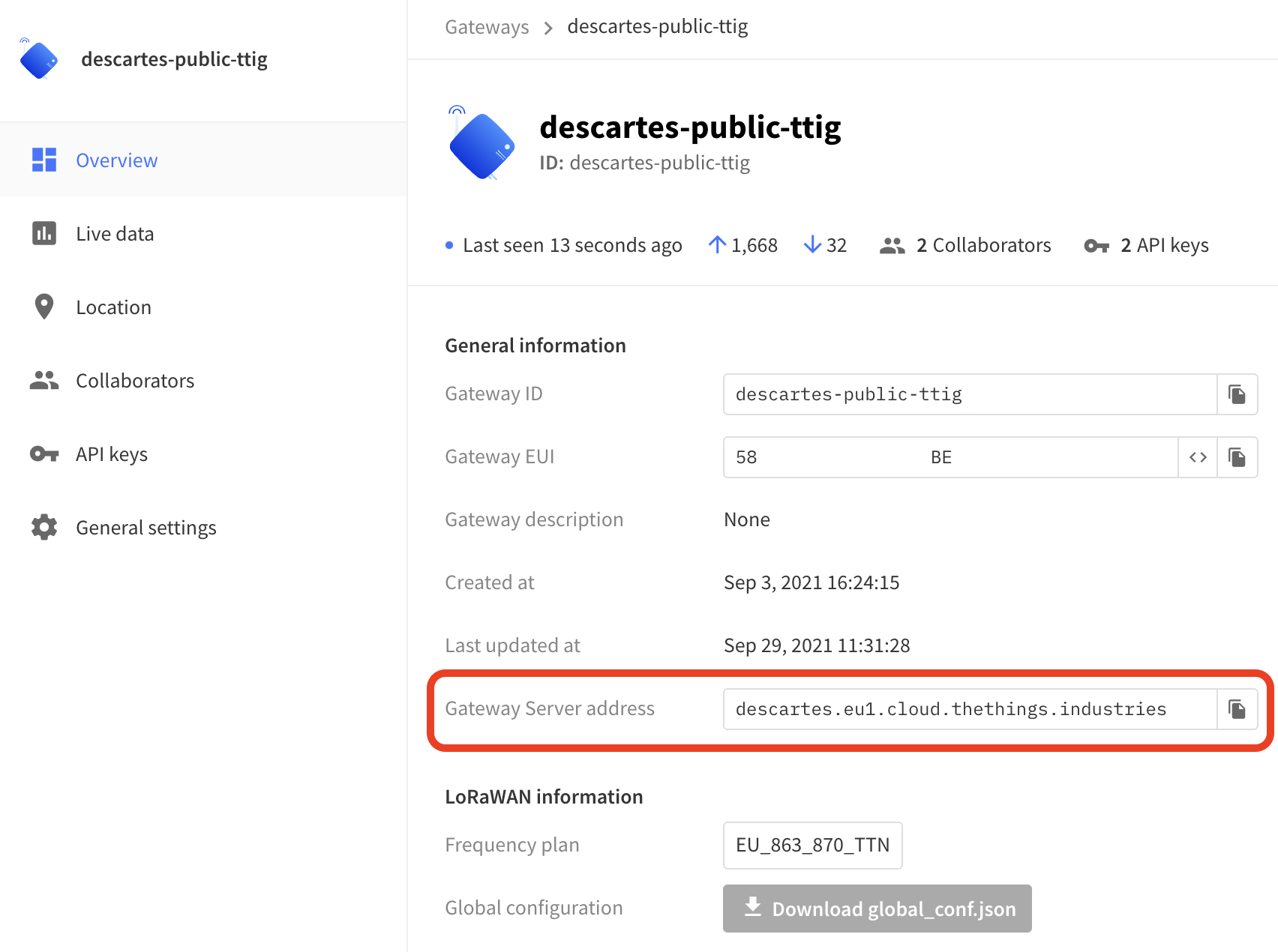

@thingsaregreat , I can see that you are using The Things Stack Cloud from the screenshot. The account server URL is going to be the same as the URL you access the console at, <tenant>.<region>.cloud.thethings.industries
Here is the URL for our TTI tenant, your tenant name will be different and your region should be the same.
All server addresses are listed here → Server Addresses | The Things Stack for LoRaWAN
Or more simply put:
It’s on the overview layout that you blanked out in your screen shot.
