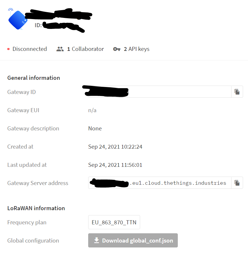

Hello,
I am not able to connect my TTN Gateway to V3. Firmware is v1.0.8.
HTTP: Starting connection<\r><\n>
HTTPS: Connection Opened: Starting TLS Negotiation<\r><\n>
HTTP: Wait for TLS Connect<\r><\n>
HTTP: TLS Connection Opened: Starting Clear Text Communication<\r><\n>
HTTP: Got 1074 bytes<\r><\n>
MON: SYS Stack size: 2833<\r><\n>
MON: TCPIP Stack size: 3759<\r><\n>
MON: APP Stack size: 4155<\r><\n>
MON: LoRa Stack size: 3909<\r><\n>
MON: heap usage: 265KB (275KB), free: 73KB<\r><\n>
HTTP: Connection Closed<\r><\n>
HTTP: Close active socket 1<\r><\n>
CONF: Parsing response token: HTTP/1.1 400 Bad Request<\r><\n>
ACTI: Failed to parse JSON: -3<\r><\n>
<\r><\n>
CNFG: Downloading gateway configuration failed<\r><\n>
<\r><\n>
CNFG: Load online user config state change to 8<\r><\n>
<\r><\n>
CNFG: Communication ERROR<\r><\n>
That’s what I get with my serial monitor. The third LED is slowly flashing, means that the activation is not working.
I tried the Gateway ID with and without @ttn, different Account-Servers and different Gateway Keys. With V2 I am able to connect.

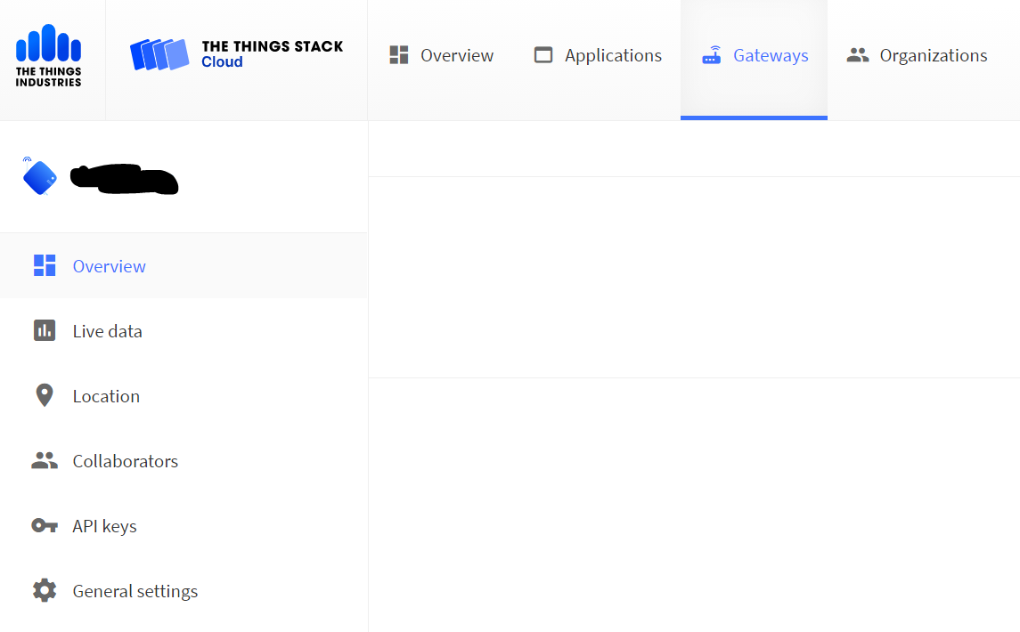

Capture
Please have a look to my screenshot. I am using the gateway ID from the top, and the gateway server address from the bottom. Is that correct?
What could I try? What is the correct way?
Thanks!
If you want to connect to TheThingsNetwork community edition you should use a gateway server address like:
eu1.cloud.thethings.network
(first part may be different depending on your region)
What worked for me:
  • DON’T set up WiFi on the gateway
  • enter the gateway id WITHOUT @ttn
  • make sure that you copied the ENTIRE API key from the console (you can see it only once in its entirety)
Thanks, but still the same issue.
How could I check if I am using the community edition?
Capture
I am using ethernet connection.
