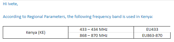

Hi Basler,
This is the answer we got from LoRa Alliance, and also one of our customer uses our gateway with 868 MHz very well.
Hope this helps.
Wow! Thank you very much, that is very good news. Now that I checked again, the newest regional parameters include Kenya.

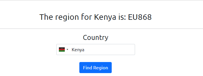

Hey, hope your good you all are good, does the EU 868 frequency work in Kenya?
If so what are the legal implications?
You should ask your national telecommunication authority about that. They have to decide whether it’s legal to use this frequencies.
So you didnt read the post 2 above yours?
Note TTN not supporting 433Mhz
Laws of Physics same across the globe - 868Mhz/Radio works the same everywhere
For any additional legal restriction on use e.g duty cycle, LBT, EIRP, etc. you need to check local regulator as Wolfgang suggests, though I believe for DC/TX EIRP it follows same as EU (IANAL)
