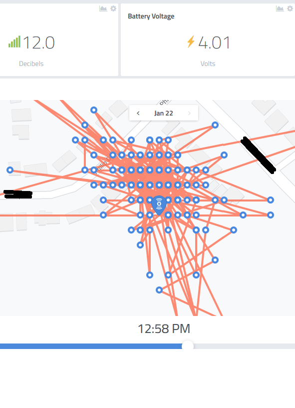

@icepicknz also be aware that without assisted GPS, or additonal RF references e.g. Bluetooth beacons of WiFi sniffing, there may be random errors and limits on precision and use case. Location averaging and over sampling for sending a partially corrected result over TTN/LoRaWAN may help a little. The below shows sample just grabbed from Cayenne of plot from a Dragino LGT92 from @edwin & friends (may be a good starting point for you to look at). Currently unit is in a conservatory being recharged for next outing so not quite an unblocked, clear view of open sky but typical of where your devices may find themslevs, if not quite in a coal cellar!
Note wide range of random plot locations (more outliers off picture as you can tell from the track lines) and this from a stationary GPS tracker with no assist or error correction. Note also the matrix of plots reflects quantisation and rounding errors due to truncation of the LLP Payload for Lat & Lon used by Cayenne in this case. As you can see without moving already seeing range >>50m!
That is an excellent example of GPS wandering about when it’s not.
