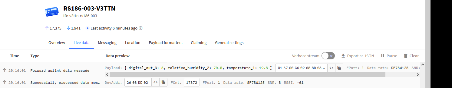

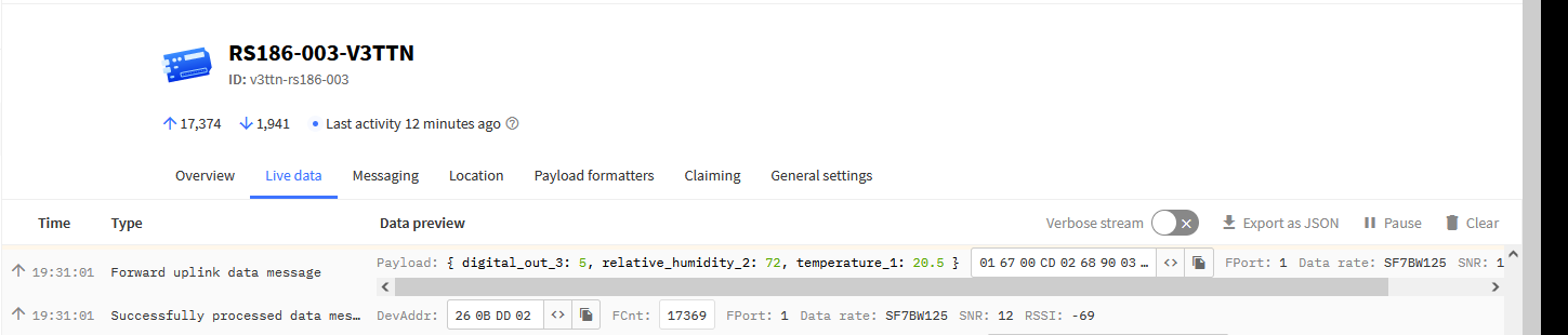

All three fridges are monitored here. See similar values across them all (BTW all are ‘built’ in types so behind cupboard doors also…) Worst gives typically -82 to -88dbm - they are in different rooms/locations.

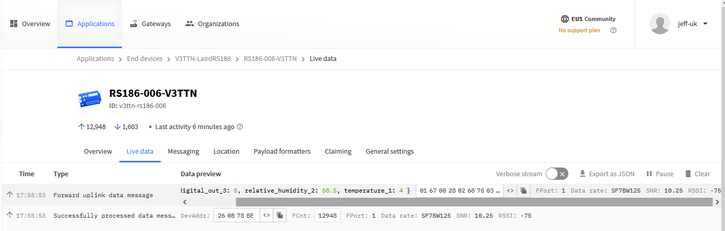

It was partly a joke back to Nick after his question, however, since you ask - A couple of data points below out of the fridge (and in open room) similar distance from closest GW (a TTIG) - tends to be the main receiver reporting relevant RSSI, one floor below a Mikrotik (approx 45deg up angle from node similar horizontal distance to the TTIG, 2 floors below test LPS8, iMST Lite & TTN KSGWs! The others capture/report RSSI if TTIG busy or misses and RSSI range is typicall -73 to -91 across the test GW suite :slight_smile:
