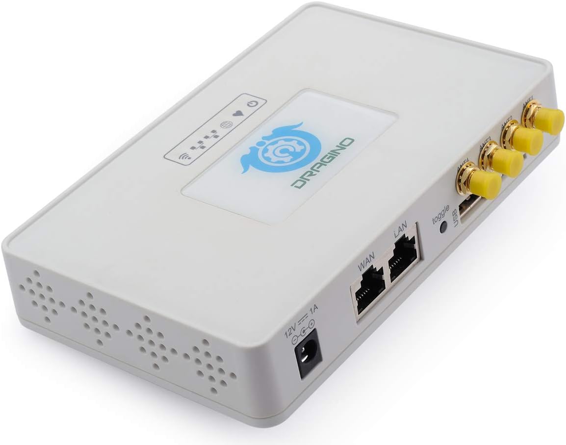

What about Dragino LG308, does anyone here know if it sends timestamps?
LoRa Spec:
1 x SX1308+2 x 1257 LoRa Tranceiver
1 x SX1276 LoRa Tranceiver
1 x GPS module for LoRa localization
Dragino spec does not list GPS.

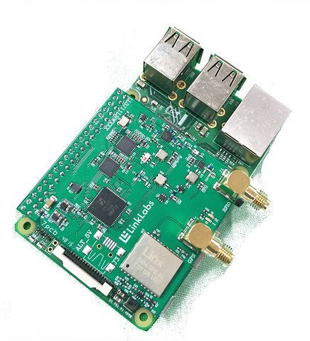

I always missed this LinkLab Shield, GW and GPS, simple and efficient
No.
There are two issues: first the firmware doesn’t support it, though you could build your own firmware from their open source repos for earlier kits which would.
The other is that you need the PPS connection from the GPS to the SX1301 chip. Probably you could modify the board to insert that.
And then you probably don’t want a laggy USB interface, but rather to use a hardware UART. The console one is definitely exposed, it looks like one of the others is but you probably have to rebuild the kernel to make it actually work: https://github.com/RAKWireless/WisCore/wiki/Introduce-uart
