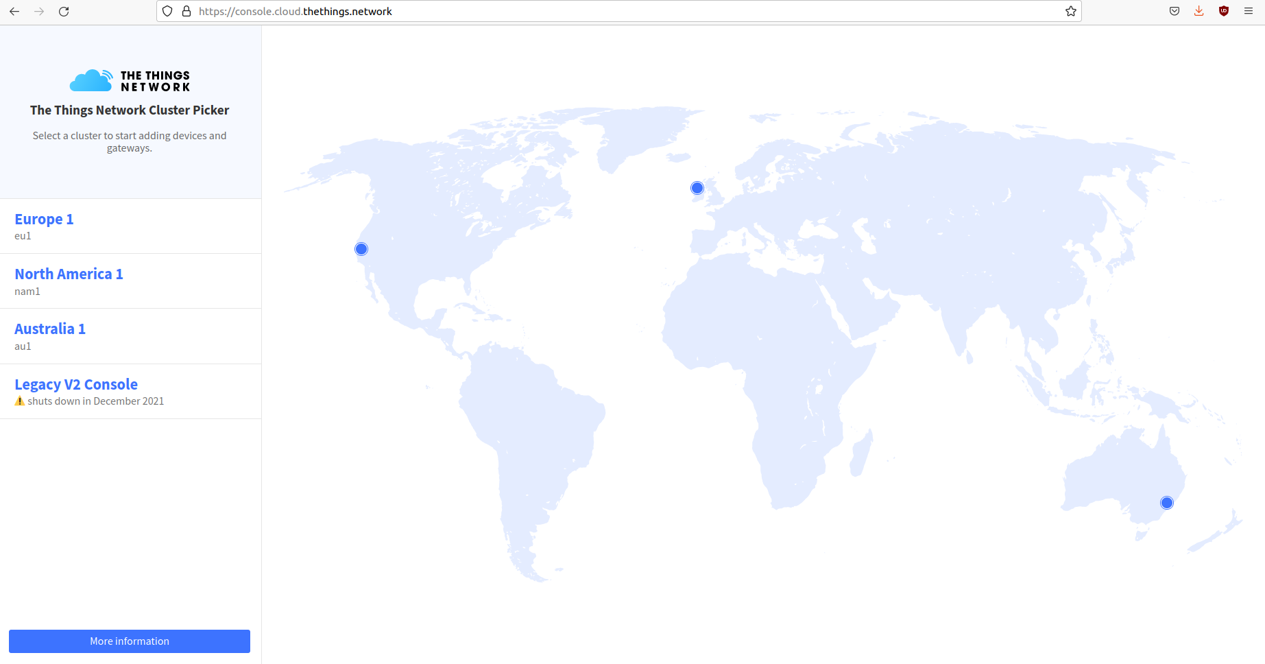

Right now, I can register devices and gateways on the North America 1 and Europe 1 clusters. All good there. However, there is no TTNv3 cluster for Japan or Asian countries operating on LoRaWAN AS923 frequencies. How do I register a gateway and device on AS923 frequencies?
Screen shot showing the 3 TTNv3 clusters(Europe 1, North America 1 and Australia 1. Nothing for Asia)
You are being a bit obtuse here - there are no clusters in Japan or Asian countries at all for any frequency - it’s not an AS923 specific detail so you aren’t overlooking anything.
You can register anything on anything but I’m told that there are some benefits in consolidating your regional specific devices in to one application.
So you can pick a console which is nearest to you so you get the best response when operating it and register your device on there for anything you can select in the drop down menu.
Gateway’s should be connected to the nearest cluster to minimise latency. So my test 915 TTIG talks to the EU cluster but is currently setup for AU915.

I have discovered that I cannot register a device on a cluster for one region(e.g. Europe 1) and and receive packets via gateways registered on another cluster(e.g. North America 1). Nothing appears on either console. Therefore, I cannot register a device on an existing cluster(e.g. Europe 1) and hope to receive packets via gateways in Japan which are registered in an unknown(ttnv2?) cluster.
