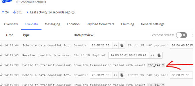

Hello, please ask a question, in Class C mode, TTN(NS) sends data too early(NS displays an error message: Failed to transmit downlink Downlink transmission failed with result Too EARLY), resulting in packet loss problems. Why? Thank you!
Everyone, please analyze the cause of the problem and give a solution. Very grateful.

Can you find the Gateway settings > Lorawan Options > Schedule any time delay setting in the TTN UI?
Try different values, you can choose bigger or smaller delays to adjust the Internet packet time from network to gateway. Would try a larger value.

I had exactly the same message.
(Failed to transmit downlink Downlink transmission failed with result Too EARLY)
I got even 4 messages always in the same seconds after a telegram.
Since I assumed that there is no error in the application I looked at the default Lora settings in the OS of my MikroTik LR8 gateway and found something there that contributes to the error.
In the server settings 8 servers from TTN and TTI were entered.
After I removed all but “eu1.cloud.thethings.network” the error messages disappeared.
Maybe this will help those who are looking for the error here.
