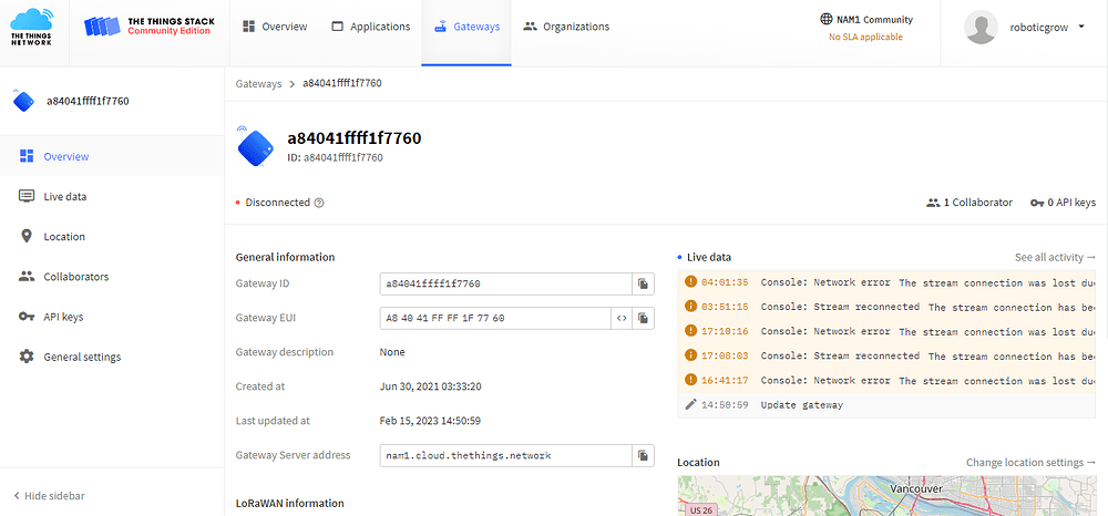

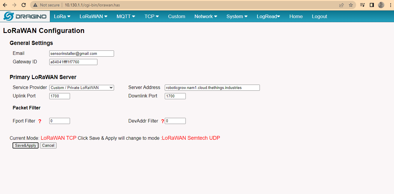

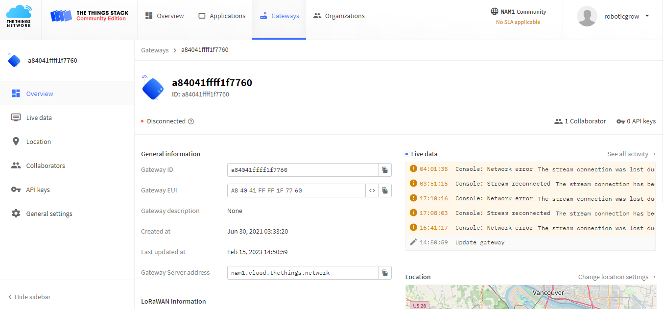

My Dragino DLOS8 outdoor gateway is not communicating to TTN. Here are a few screen shots for reference. Any ideas?
. It was working about 5 months ago. I am at a loss as to why this is not connecting.
The server address is wrong for the community network. For North America use nam1.cloud.thethings.network. Nothing in front of nam1…
That was it. Wow, thanks! It is showing up in TTN and Tago.io. Much appreciated!!
