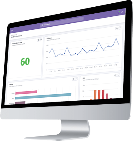

As you are probably aware, the sneaky way to gain consent is by offering free wifi.
For quite some time now, it’s been used to track customers. i.e. measure footfall within a store - where one goes, date/time, how long you stay there and the holy grail - a link to your spending profile / history with loyalty card references,
How tracking customers in-store will soon be the norm | Big data | The Guardian.
The tech is already well established, its the clever ā€œjoining the dots and data miningā€ bit thats not quite there yet.
I guess one of the reasons why they are able to comply with regulations is because measurement is within their property/store. Where it is getting out of hand is the joining of separate loyalty card data, so people are effectively tracked wherever (all by consent of course).
I went to a talk recently where a large database provider mentioned they are trailing such a system for a major food retailer in the UK - the real people the law is aimed at.

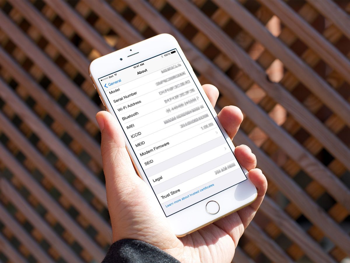

It seems that is more a fun project or show case than a real world application. Because all iphone devices sending random mac adresses for preventing sniffing and tracking the person. Many Android devices has the same feature, so you will count one person with an iphone as many persons. Same is when on one device BLE and Wifi is active, it has different mac addresses, so you will count one person as two.
But this project is very good to share ideas and inspiring other people to create appplications with Lora. In our TTN Freiburg community, we already discuss about that project and will be discussing that with our local public transportation provider (they have interest in lora, but no usecase at the moment). We have the idea, not to count Wifi or BLE, we uses radar to detect entering or leaving people in a tram.
The randomization will probably disrupt this use case in next years, since Google, Apple and Microsoft (Win 10 already has randomization) are not interested in loosing their advantages on data crawling.
But currently the code seems to generate surprisingly good results.
There are some articles on the web which describe how wifi tracking can be possible even with randomization, if ā€œfingerprintingā€ algorithms are used, that sniff and store additional data, e.g. timing behaviour of wifi clients. But i’m not planning to enhance my code with those privacy sensible features. The code shall, as you explain, give a simple but impressive use case example for what can be done (and, at the same time, should not be done) with sensors in an LP WAN.
Yes, as I understand it, current radar techniques (or PIR) don’t differentiate between people i.e. the sensing process does not identify and store some sort of ā€œTagā€ per person, and this is why it would be exempt from the law.
N.B. When you have ā€œfree wifiā€, it doesn’t matter if your phone has a random mac address, it is identified and the mac address is fixed whilst you are (automatically) wifi connected.
Its interesting that ā€œFree wifiā€ is used as a vehicle to get consent (which will be more obvious soon as Kersing says), and also to get round Mac address randomization.
There are some studies on the net on this topic and what’s coming beyond wifi randomization: device fingerprinting.
