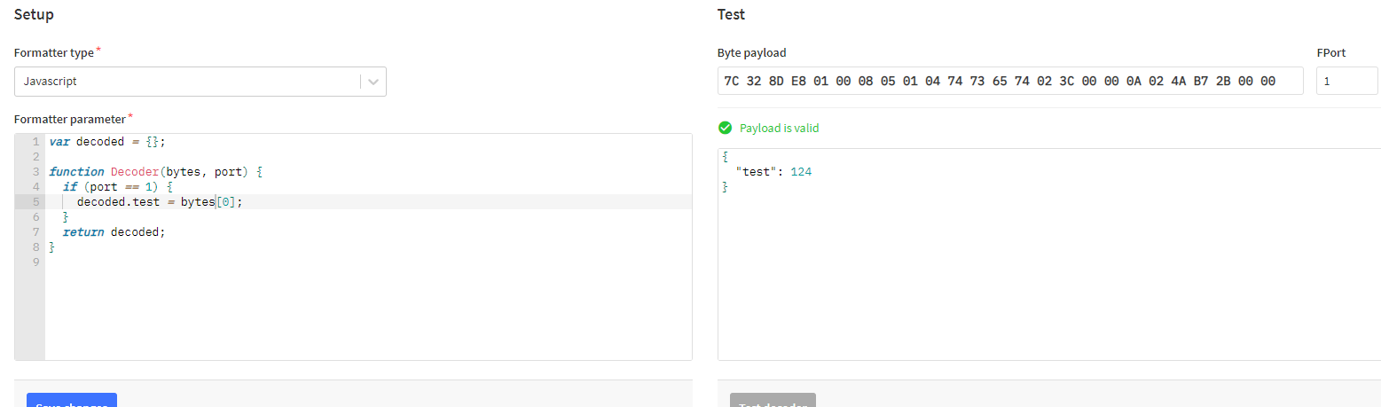

This is my code to convert the first hex value (7C) to a decimal number (124):
var decoded = {};
if (port == 1) {
decoded.test = bytes[0];
return decoded;

I have this:
I want that payload (starting with 7C32) into a variable so I can make a script to decode it following the guidelines of the datasheet I got from the company of the sensor.
You always need to start small so I want in the output section to see 7C and not 124. I tried several things but always without success.
It would be so much easier to see if a payload formatter is available - what is the device and where can we see the data sheet?
I still don’t understand why it needs turning in to a string but Google has come up with so many results for “javascript byte to hex string” I don’t know where to look / start. Maybe you could review the options. Also, are you able to iterate over the array - if not, Google for ‘javascript for loop’ - not completely efficient but will get the job done.
