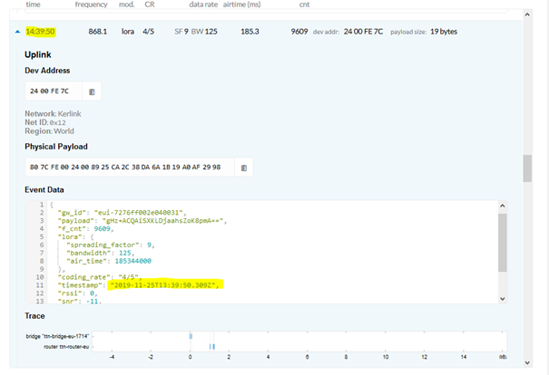

This is the time in the backend:
So, the time of reception was 13:39:14, but the time in TTN is 13:39:50.
Coud someone please check, if this is an issue in the TTN backend? Or maybe the timestamp is not used for some rason and substituted by current time??
