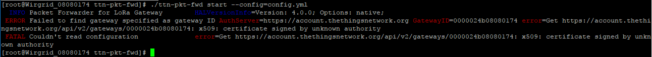

(Also, like I already asked in a private message: please don’t use screenshots for terminal output.)

Could you help me with this issue below?
[root@Wirgrid_08080174 ttn-pkt-fwd]# ./ttn-pkt-fwd start --config=config.ymlhttps://account.thethingsnetwork.org/api/v2/gateways/0000024b08080174:  x509: certificate signed by unknown authorityhttps://account.thethingsnetwork.org/api/v2/gateways/0000024b08080174:  x509: certificate signed by unknown authority
