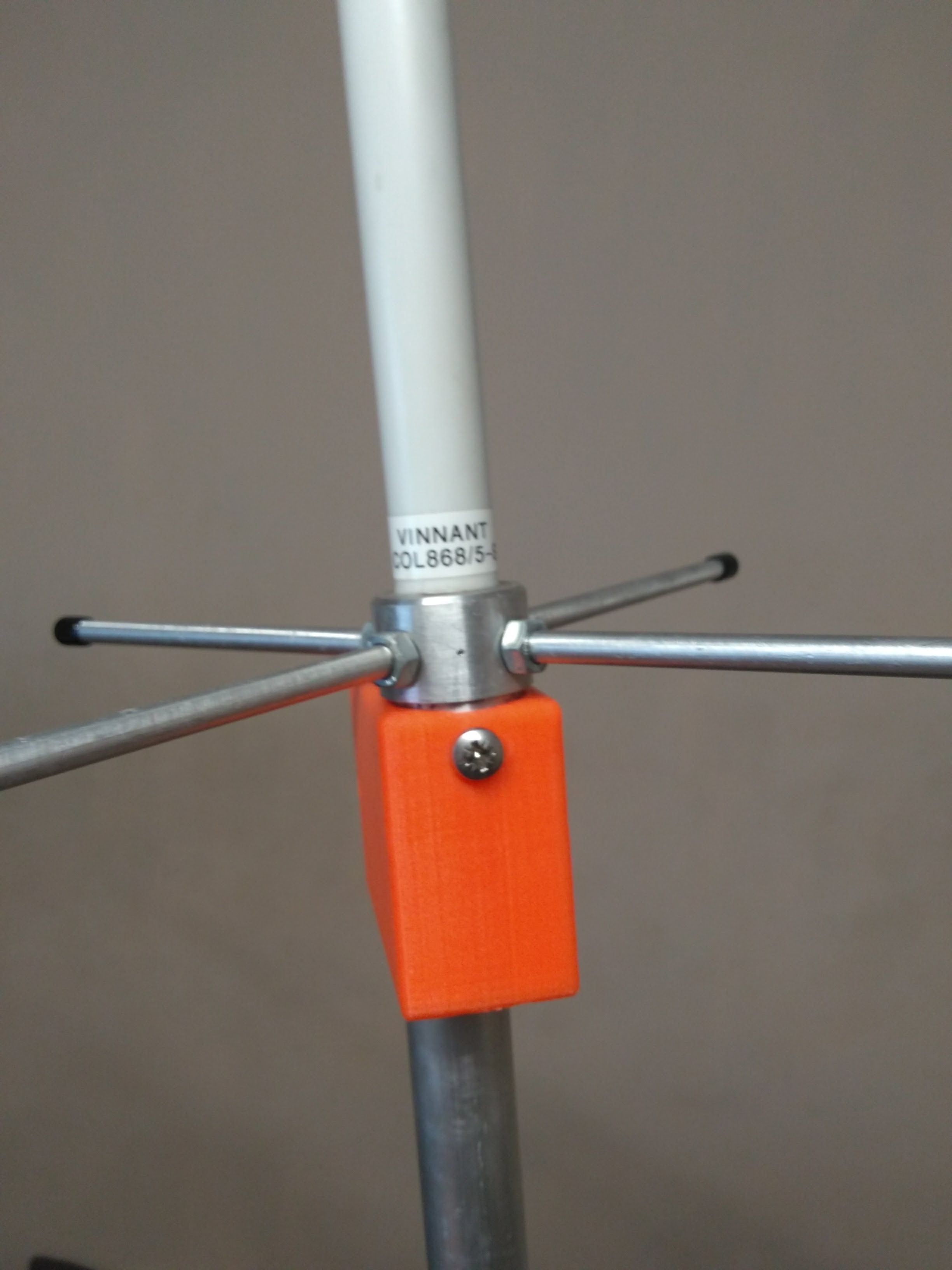

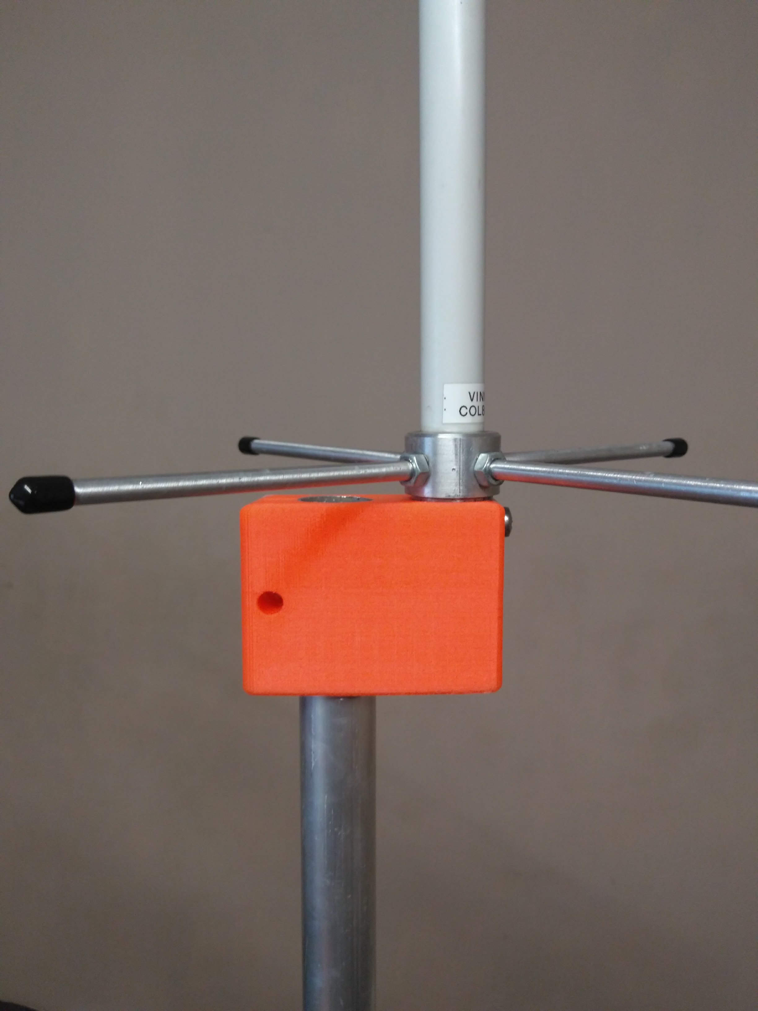

Just finished printing out a mounting bracket for my antenna to my mast.
Antenna slots in one side and screws in with a screw replacing the metal it came with. The other side slides over and then clamps together with a M8 bolt and Nut (recommended to be a nylock nut) to hold onto the mast pole (1" Diameter).
Designed for the popular “vinnant col868” on ebay here, and most 1" Diameter poles such as this one from screwfix or cpc (UK)
Printed at around 20% infill, 0.2mm layers, around 4 Hours print time. Seems really solid and more robust than my previous method of attaching the antenna to the pole. Designed using tinkercad
I might have the files up on thingiverse soon.

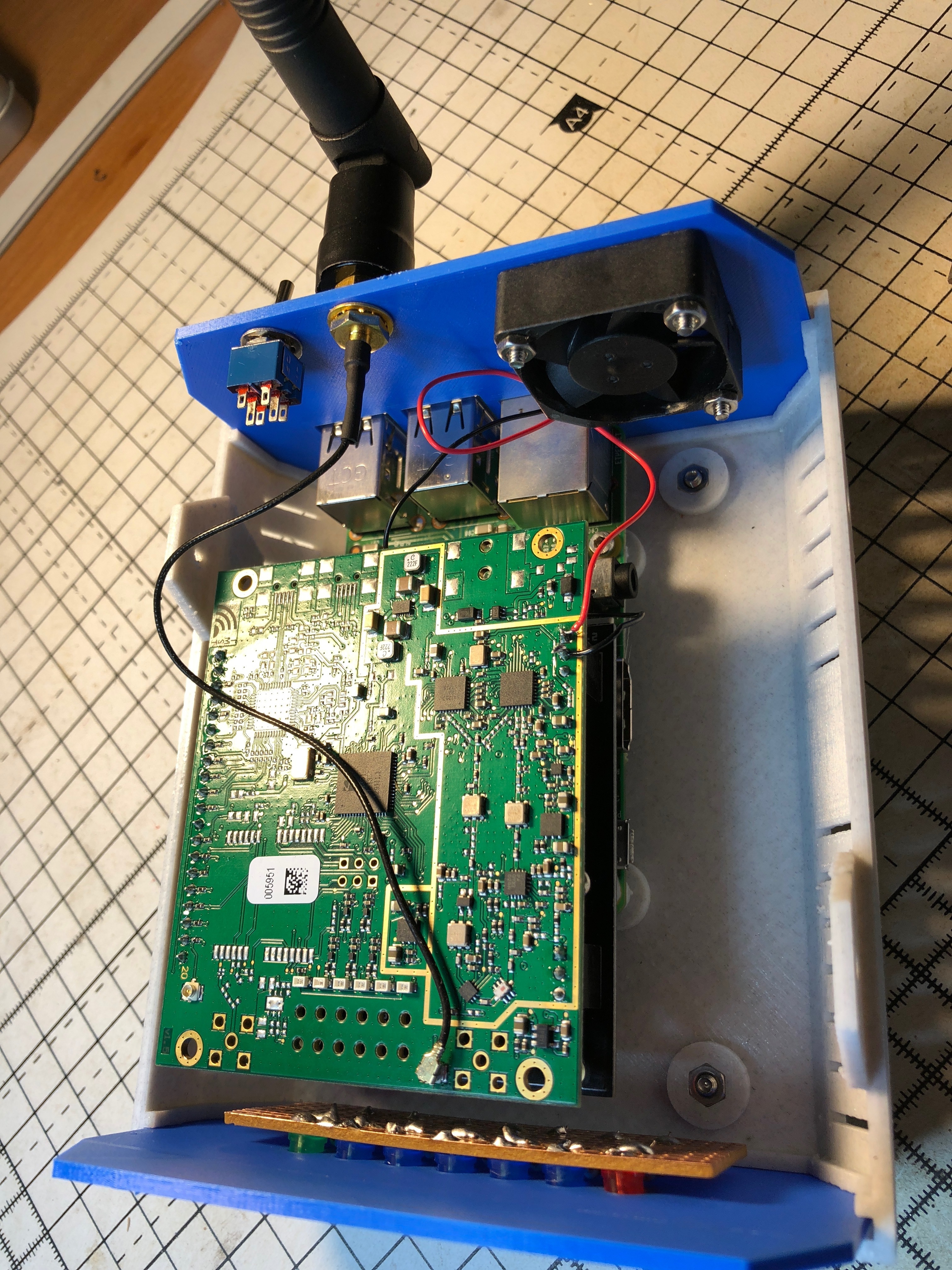

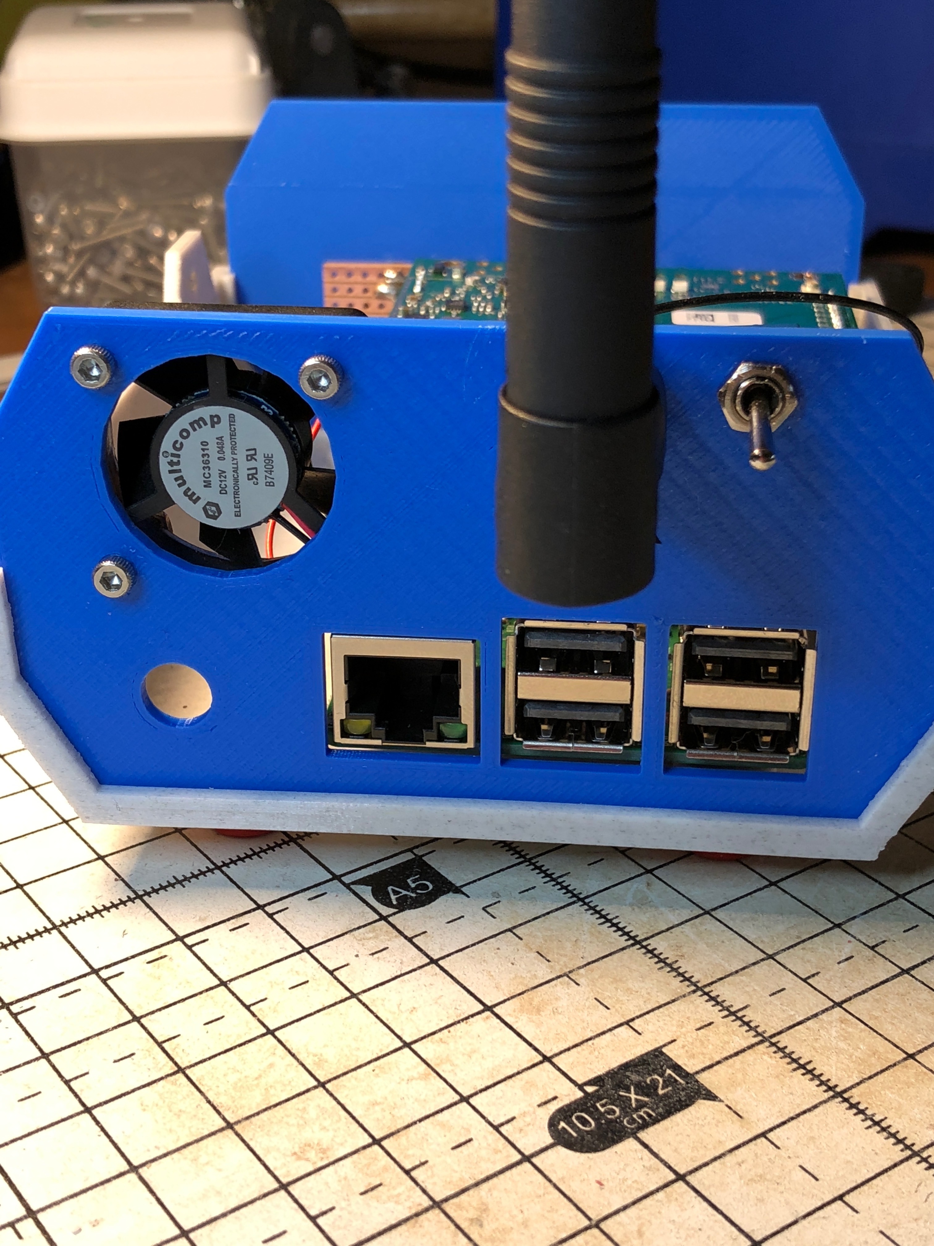

Making good progress with the case.
I’ve moved the fan and other connectors to the rear plate. Added a power switch. Haven’t yet done the power socket as it hasn’t arrived. Fan needs guards too, next time I’m editing it. I cound’t find a nice 5V 30mm fan but remarkably the 12V one I’m using for now does spin up:

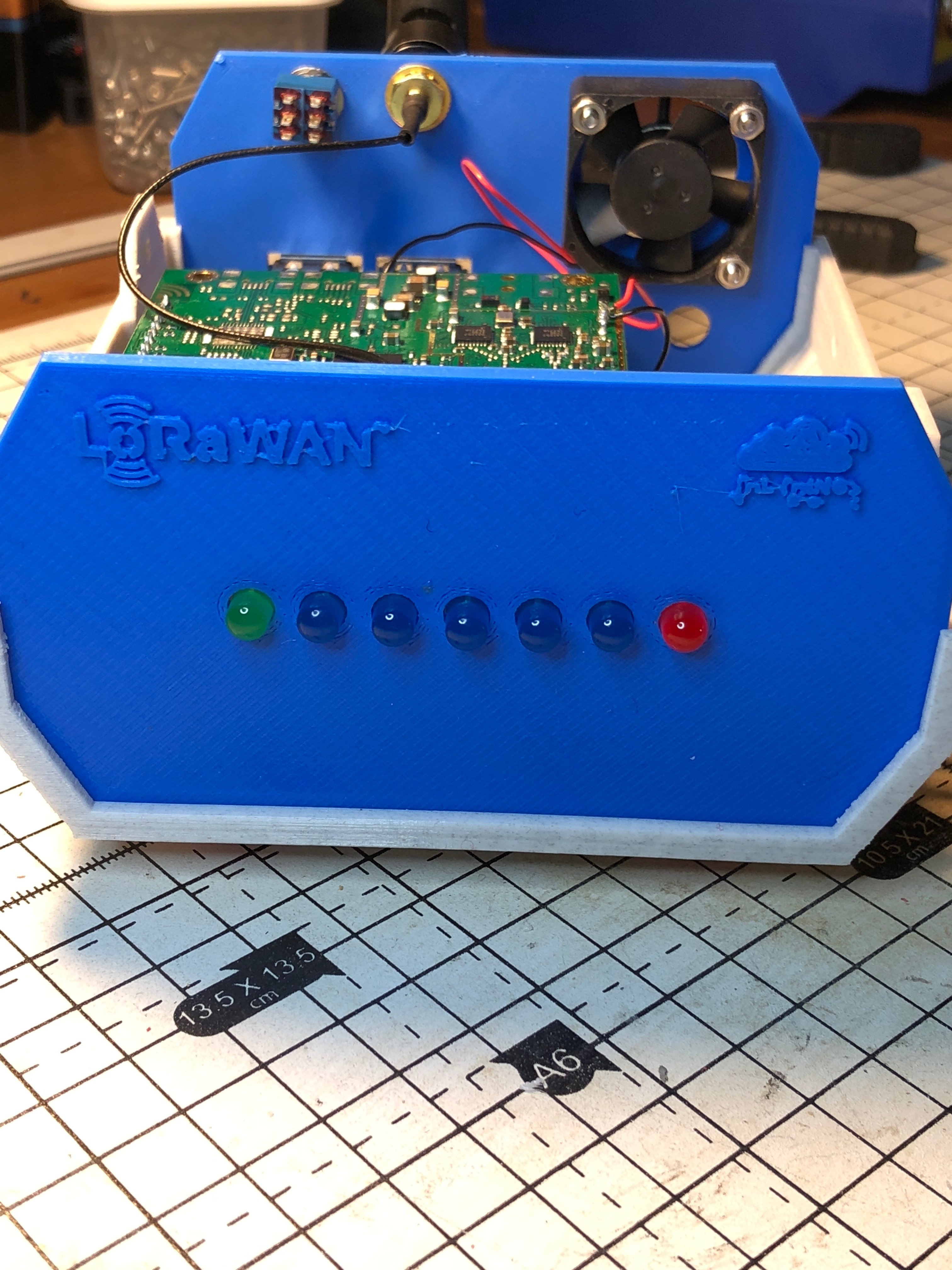

I’ve added an indicator panel to the front; from left to right they are power, the 5 GPIO indicators from the iC880a (same mapping as the SMD LEDs), plus TXD from the GPS module:
(Yes, I do have inline resistors with the LEDs
These are closer to final print quality, but still need tidying up. Although the tolerances and fit are pretty damn good:
Just printing a top case now which has mounts for the Neo6 module and ceramic antenna. Will post some more when finished.

First print with them… TTN one is too detailed at that resolution, I’m going to drop it and make the LoRaWAN one bigger. Also have a nice antenna logo on the case top which is printing now ![]()

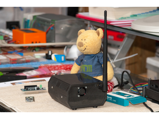

It’s alive!
I love the smell of Napalm hot PLA in the morning… It smells like, victory!
