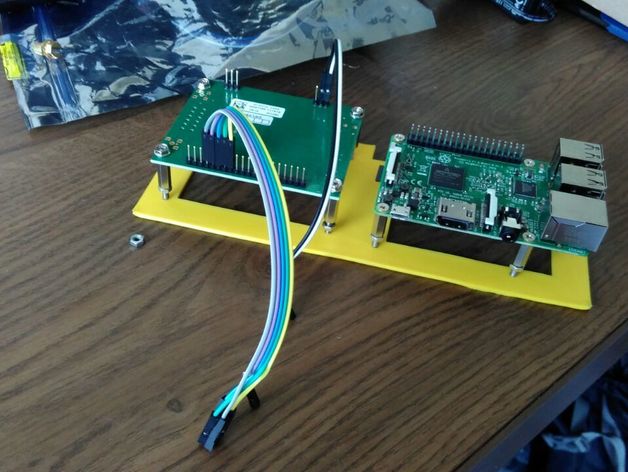

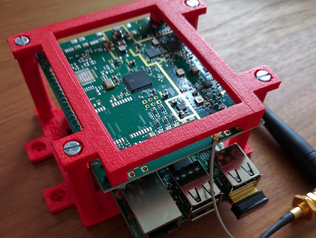

Two 3d printed GW holders:-

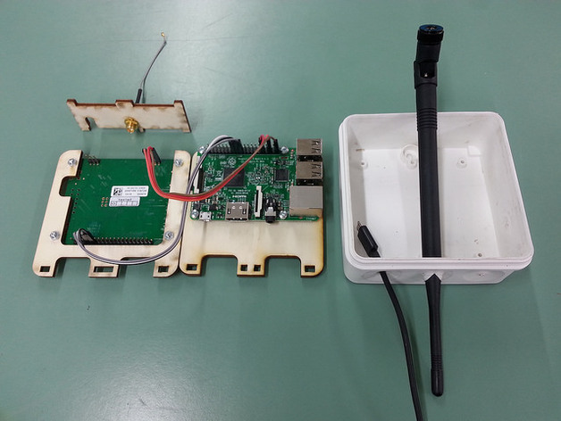

And one laser cut/wood version (ok not 3d printed in plastic but better for the environment?! :-)

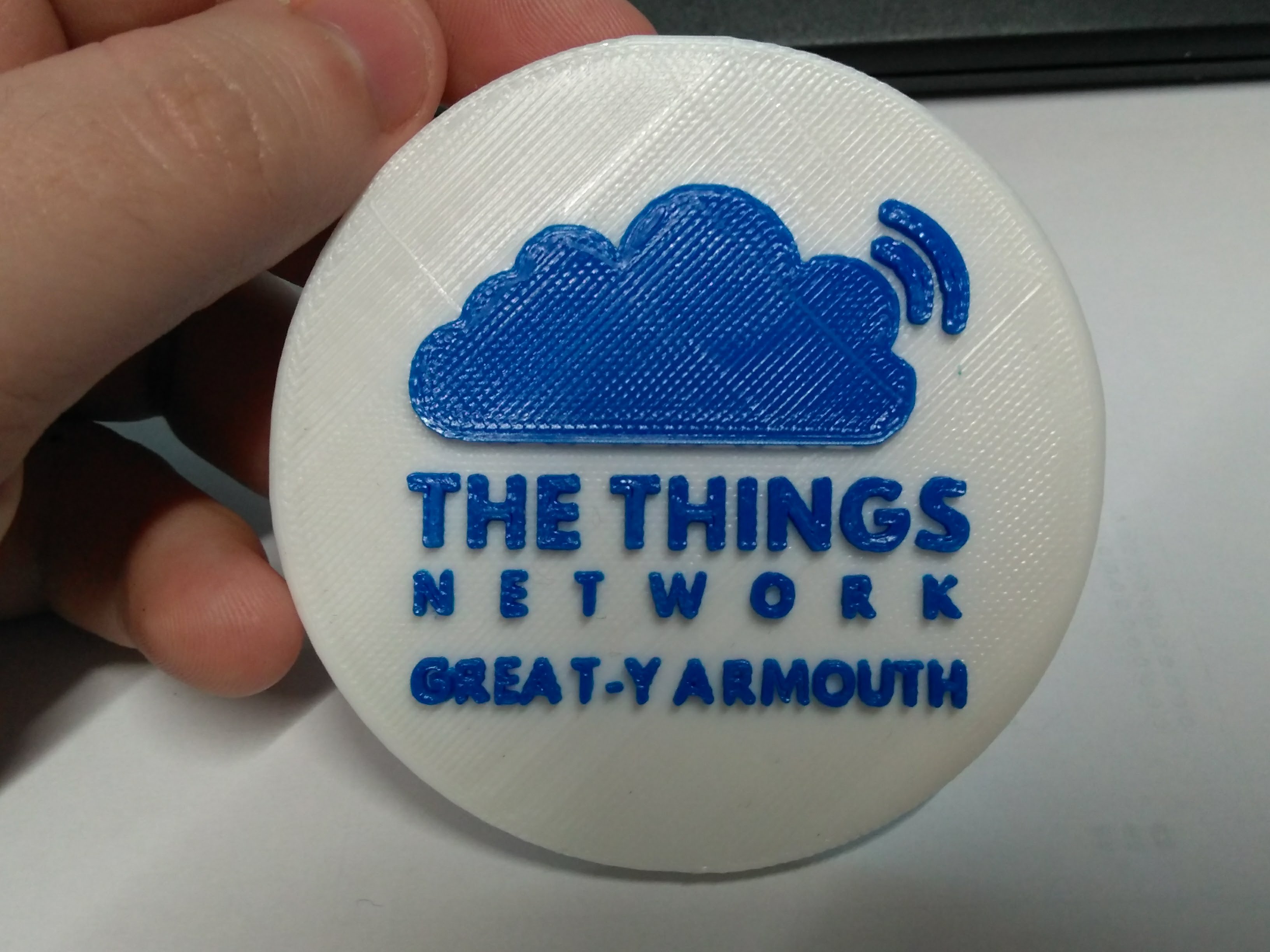

Just a simple 3D print,
Circle shape in tinkercad with the SVG import function.
Single colour STL as I only have a single extruder, pause at Z plugin in cura.
Simple TTN Community Badge printed

Repetier Server and Octoprint are ideal for Pi. Astro print also works great and has some pre-done slicing profiles which most of the time are good enough to just upload the STL to their cloud system and then click print. It’ll then slice and download to the RPi. However I used cura for the badge due to needing the Z height pause.

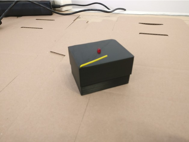

I also have something for my ‘trakker node’:
