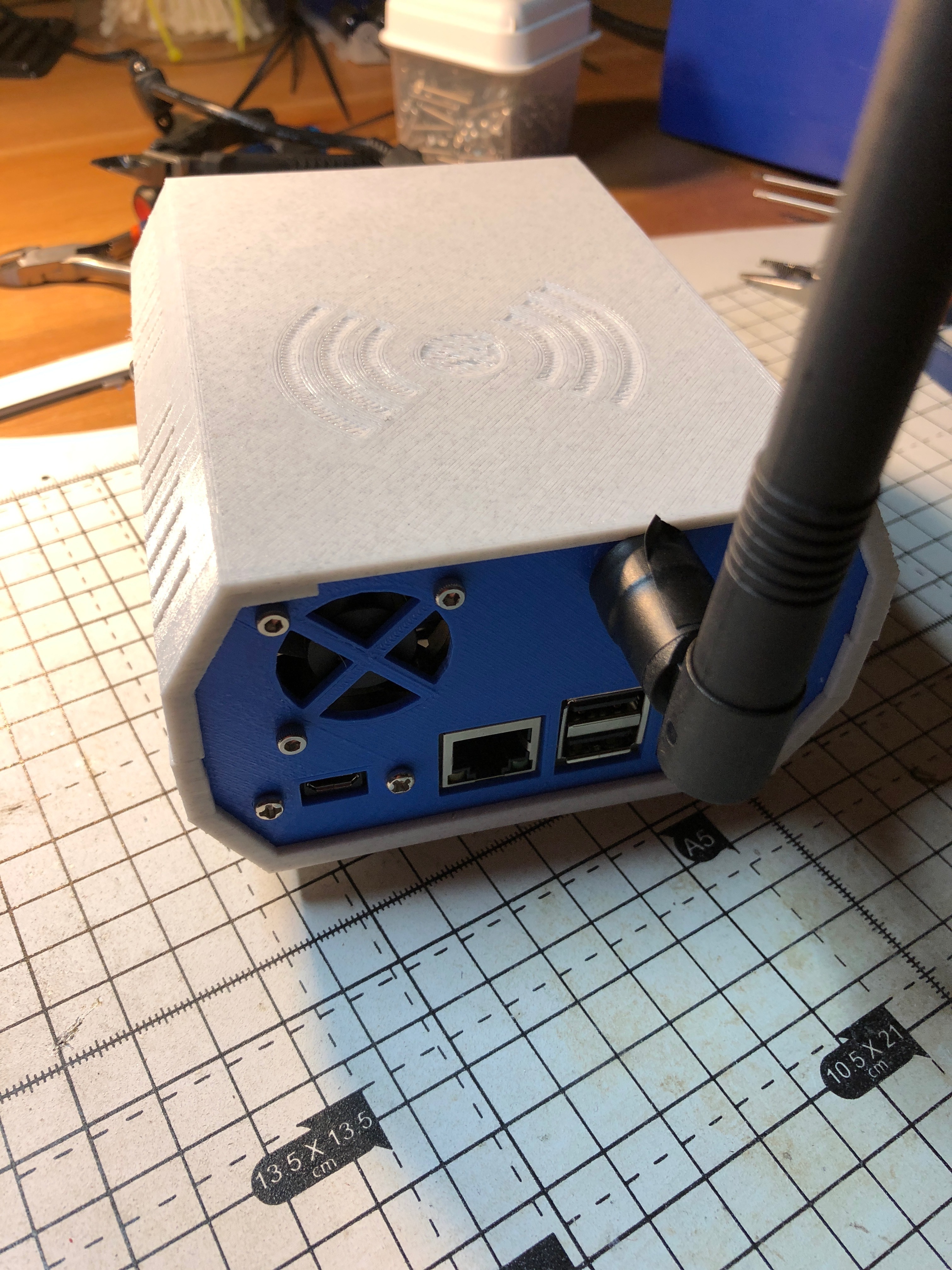

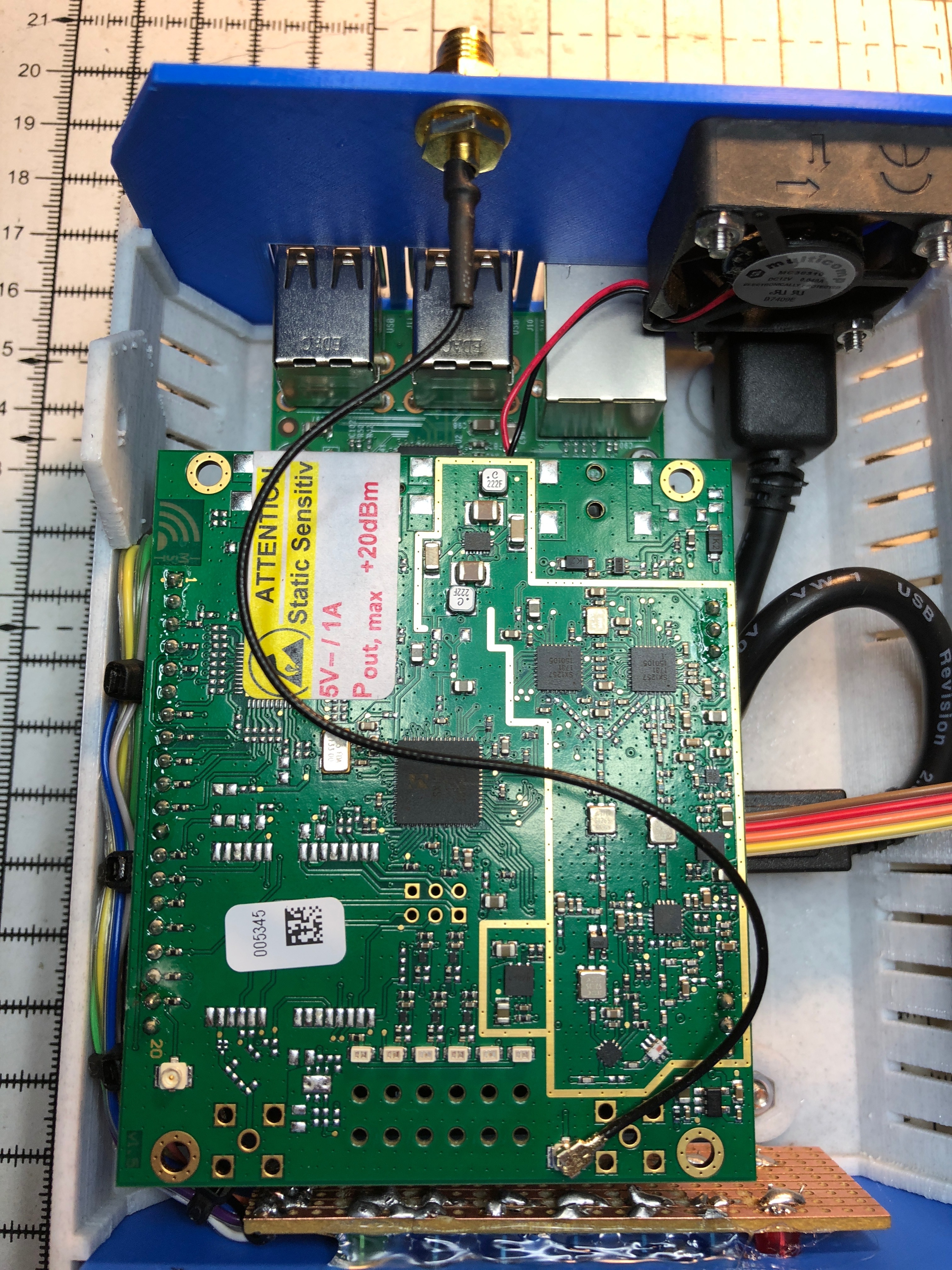

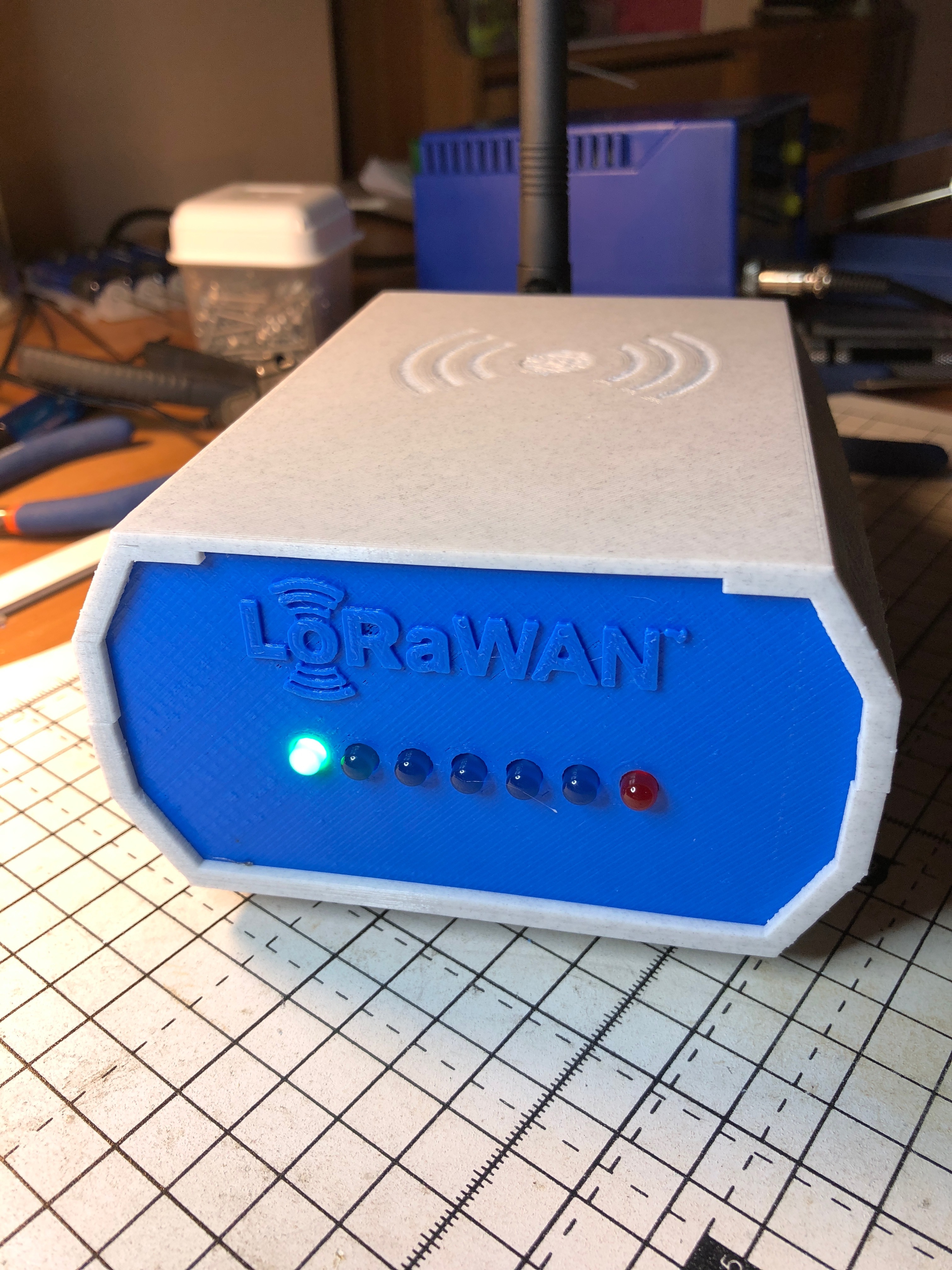

Finally finished my gateway and enclosure. Really pleased with it - perfect combination of electronics assembly, design, 3D printing and engineering :slight_smile:
STLs and notes here: https://www.thingiverse.com/thing:2825049
Thanks again to @Amedee for the inspiration!

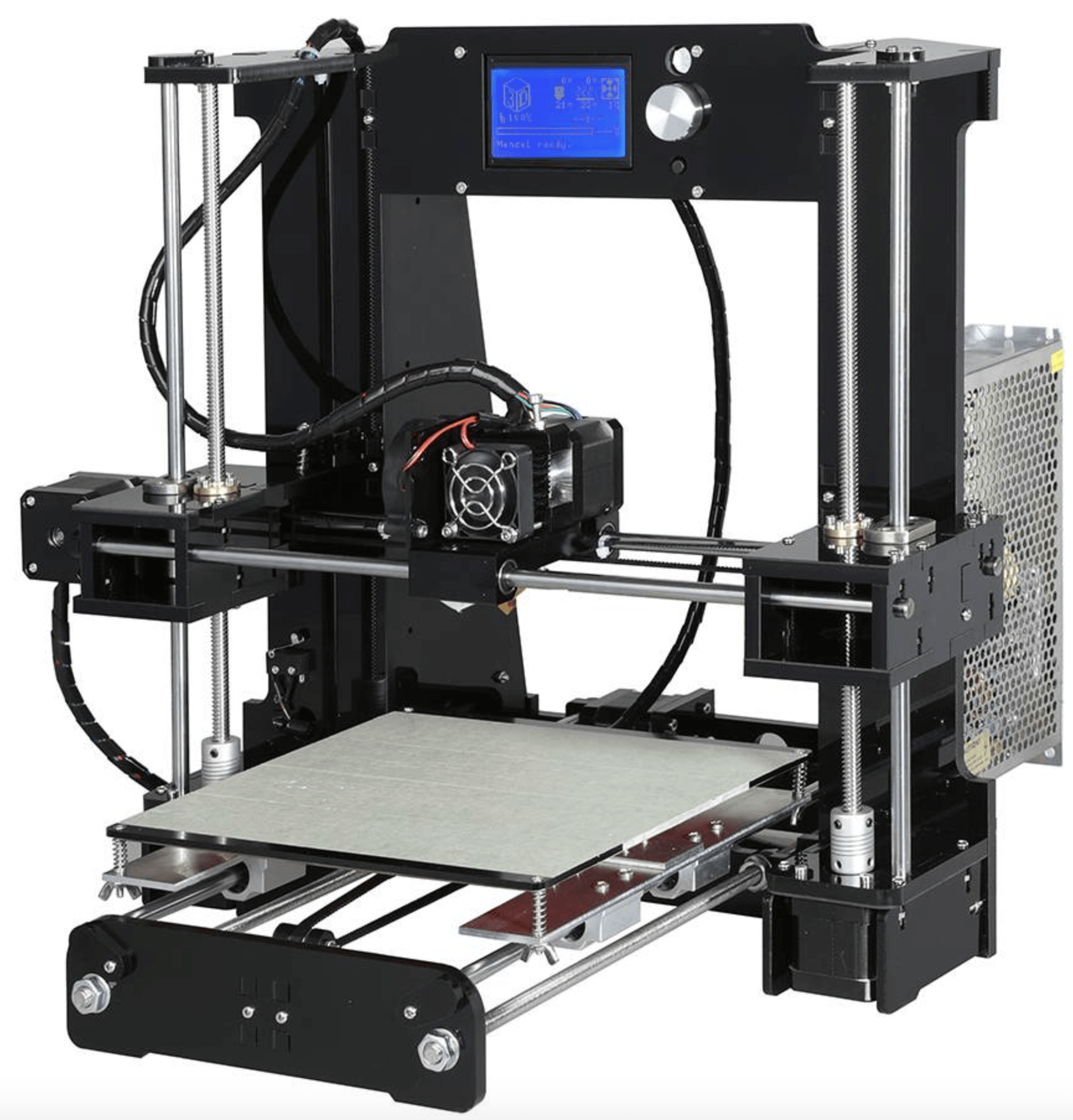

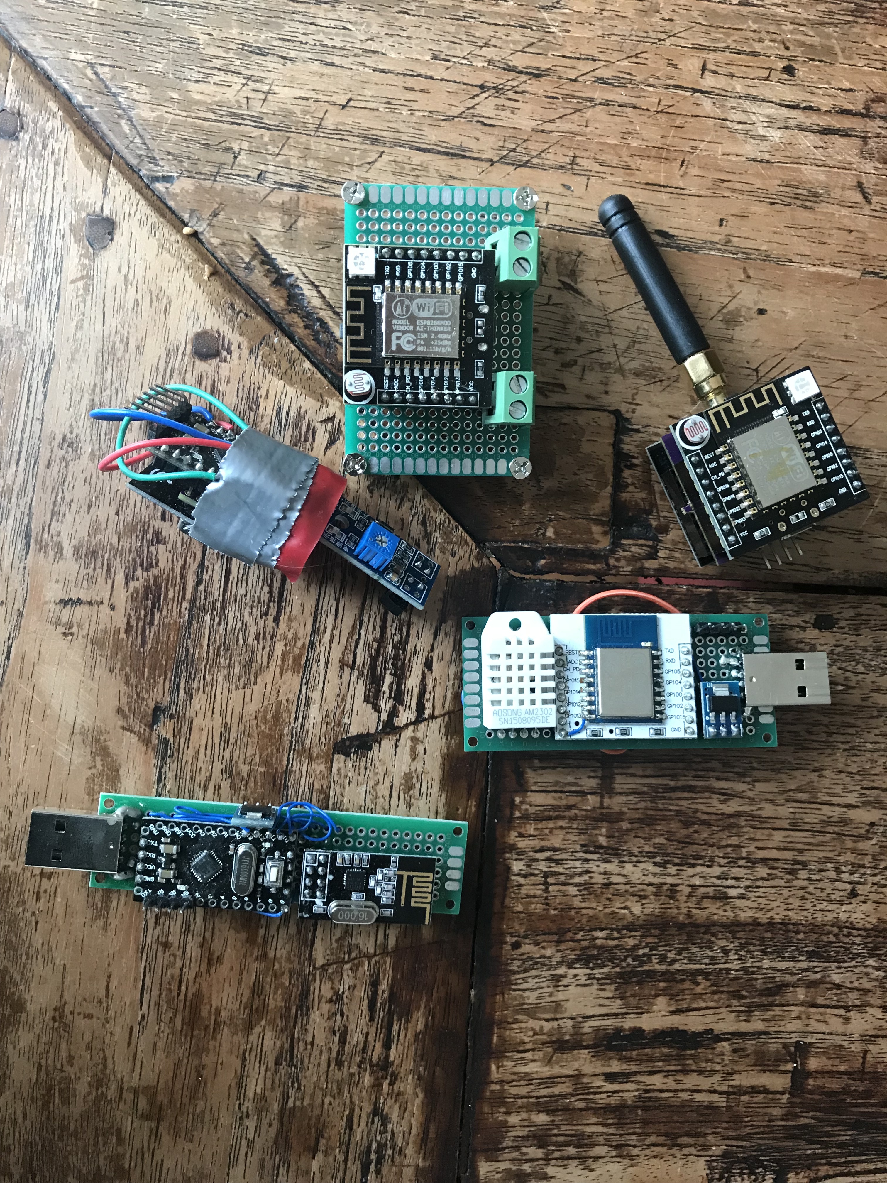

Reading up on this thread made me think. Do I really need a 3D printer? Looking around my worktable gave me a clue. So many unboxed projects.
As tinkering is the hobby decided on a Anet A6 diy build.
Waiting for delivery in couple a days to start the build.

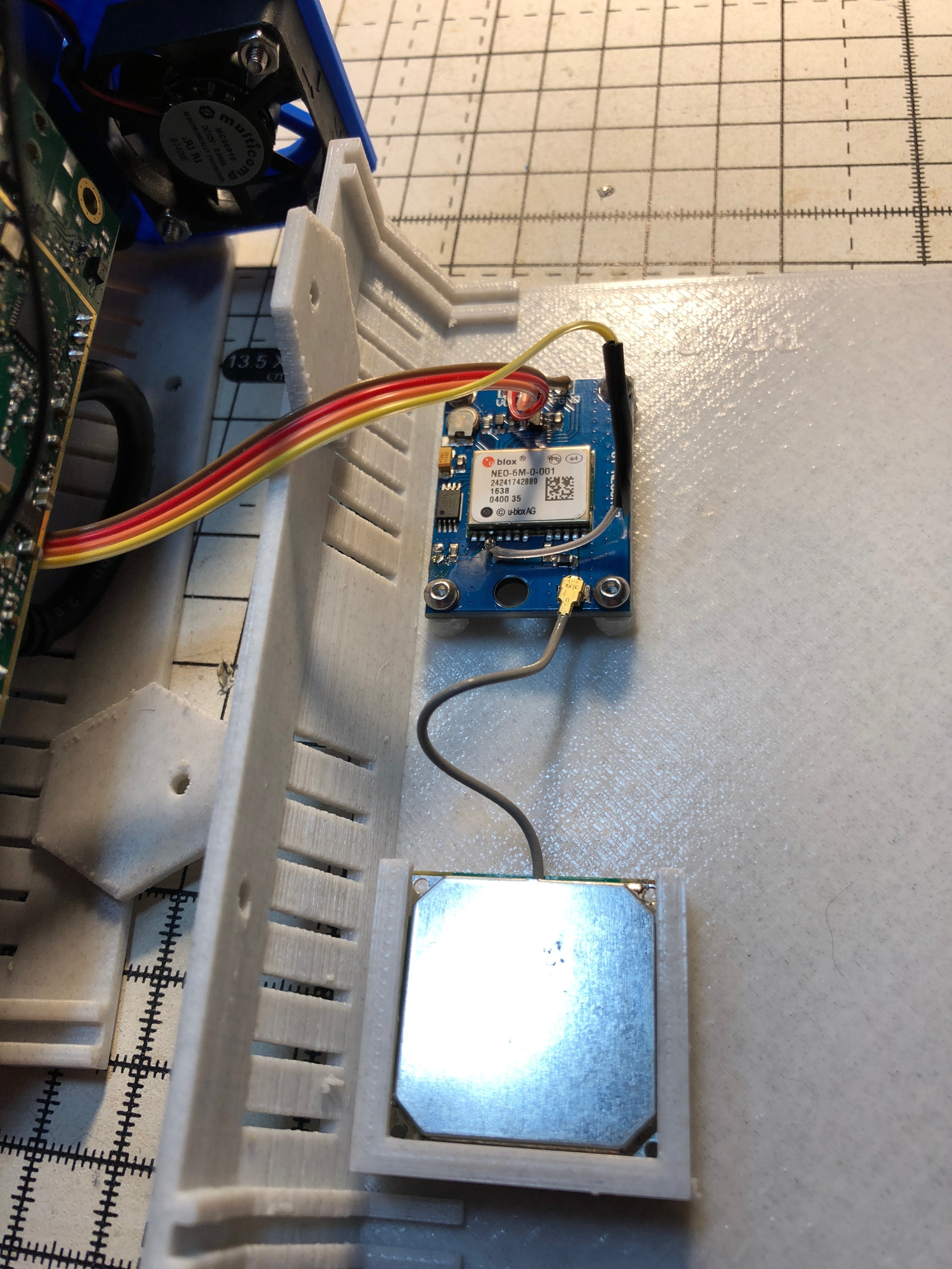

I’ve been working on an air quality monitor for the local city. The first generation units were 3D printed, stuffed into a PVC pipe, then hung on the rail next to EPA monitors to characterize sensor performance. Those are using WiFi to send data to a local LTE modem to be recorded and presented on a public website.
I’m now working on the 2nd generation units using the HelTec ESP32/LoRa boards I discovered while reading these forums. Before developing the outdoor version, I wanted to make an indoor unit that I could use for software development and demonstration.
Here’s what the enclosure looks like modeled up in SketchUp:
Some action shots of the assembled unit. These were printed on a Prusa Mk2 (Prusa printers are seriously top-rate, you get what you pay for here) using Atomic Sapphire Blue PETG Pro.
The unit has a PM sensor, O3 sensor (which also provides temp and humidity), along with a GPS module. This is all sent to a ThingsBoard deployment on a cheap VM in Azure for a realtime display of position and sensor data:

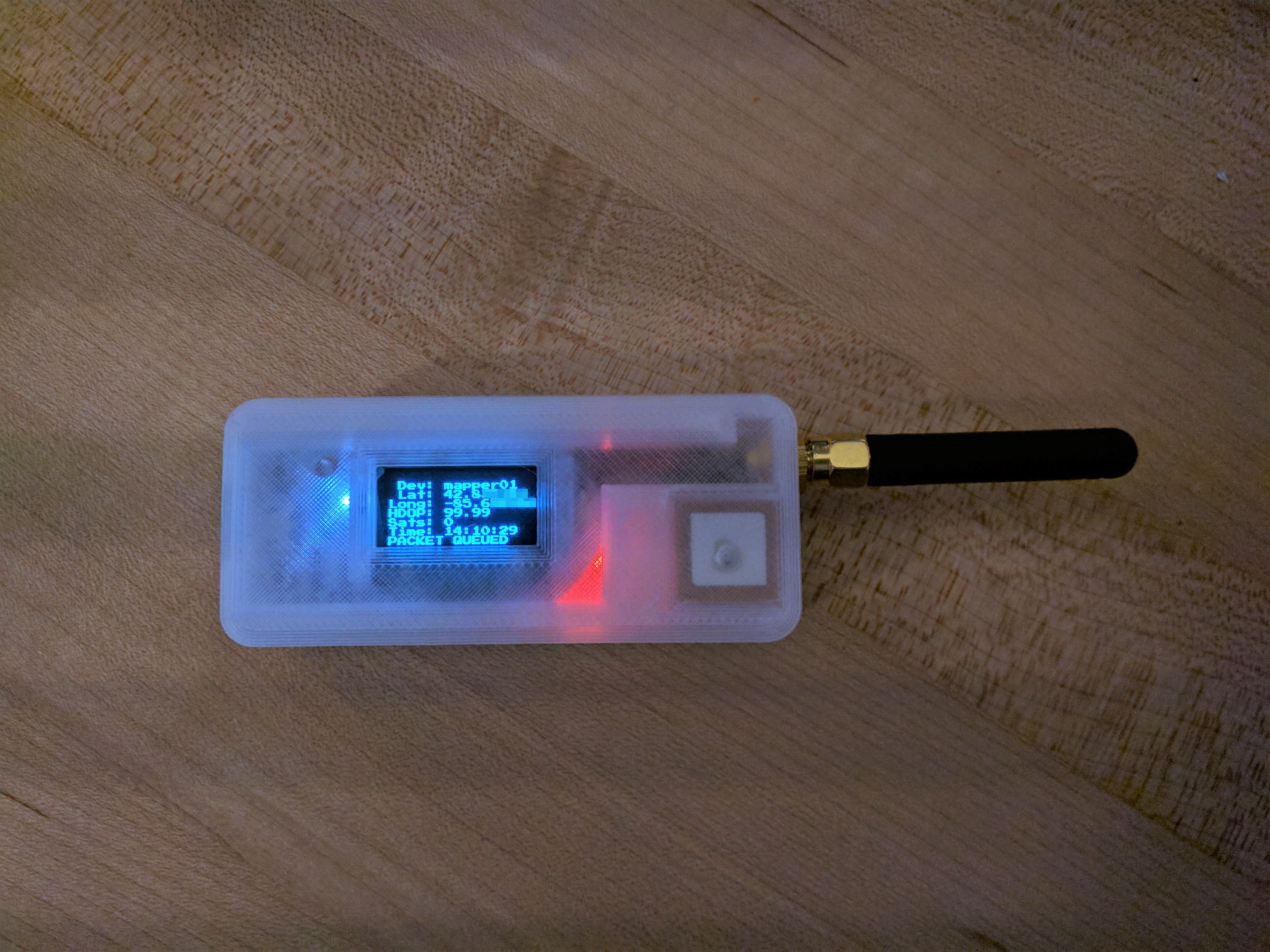

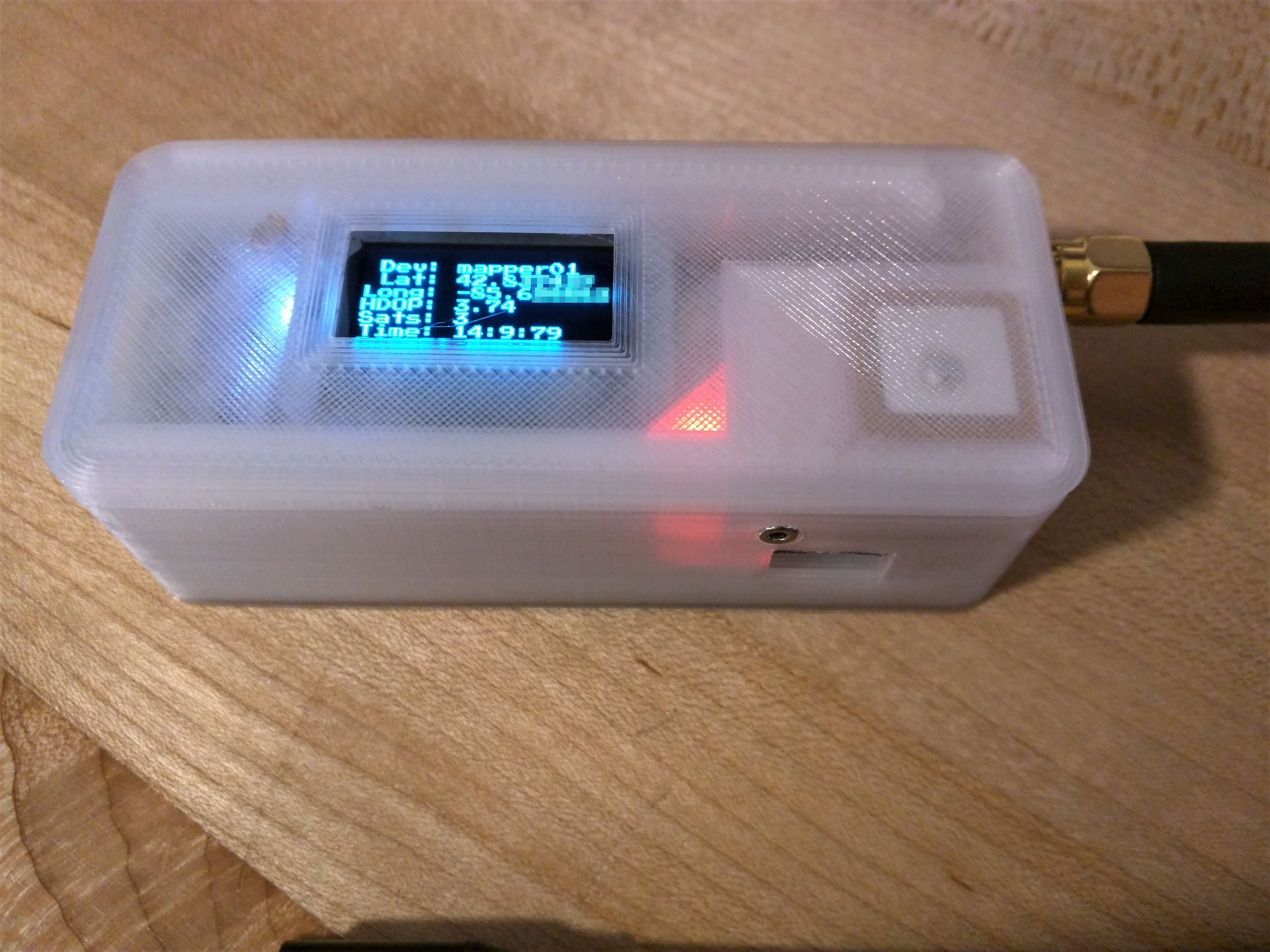

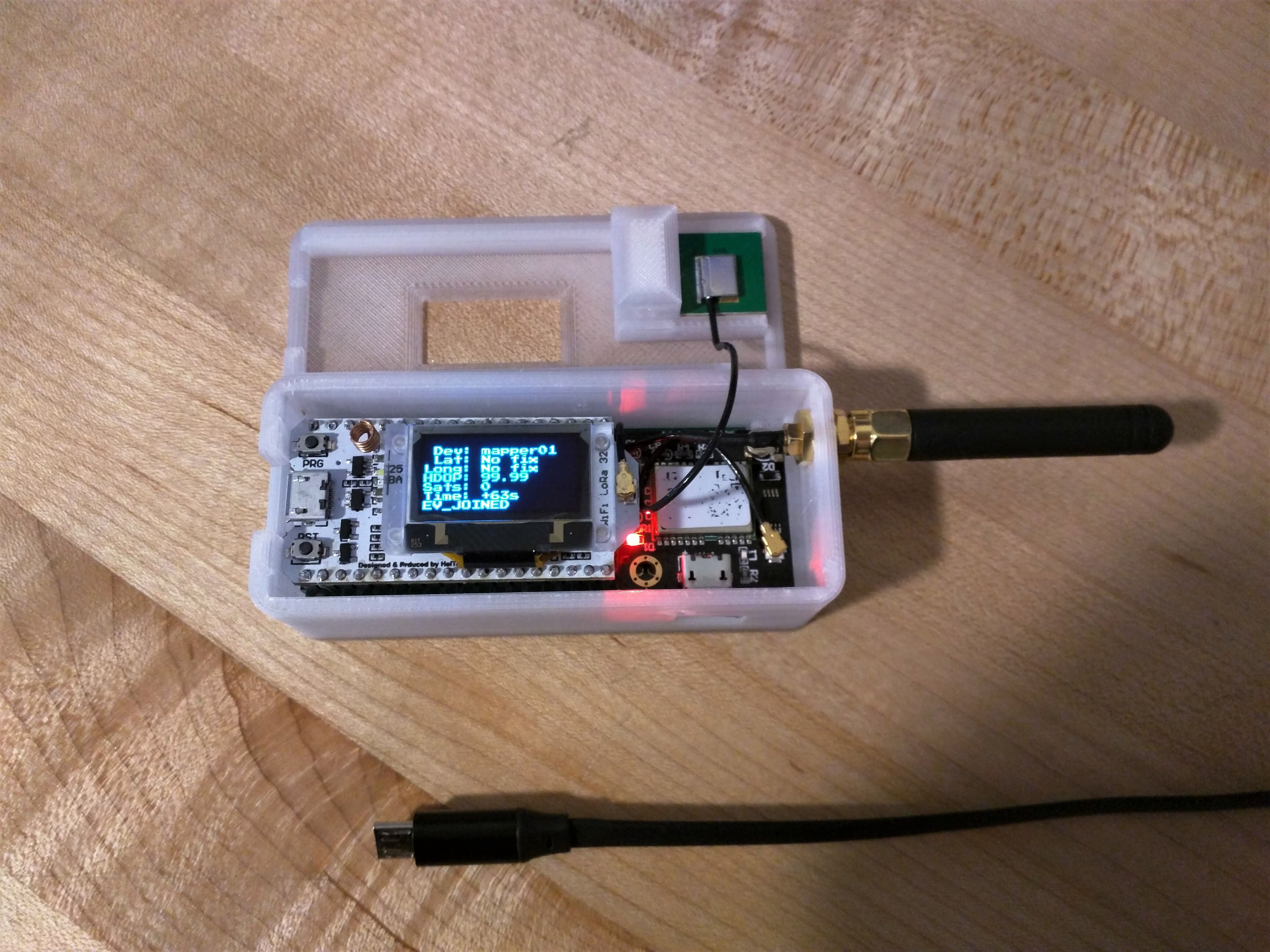

While working through a LoRaWAN deployment for the city, I thought it would be helpful to be able to map out coverage, so I also wanted to build a quick TTNMapper device:
That’s another HelTec board (same as the previous post), another cheap GPS module, and a 270mAh LiPo battery that will run the thing for all of maybe 30 minutes. Zero effort has been made to power optimize this thing, but the results have turned out pretty solid for the limited use it’s seen thus far.

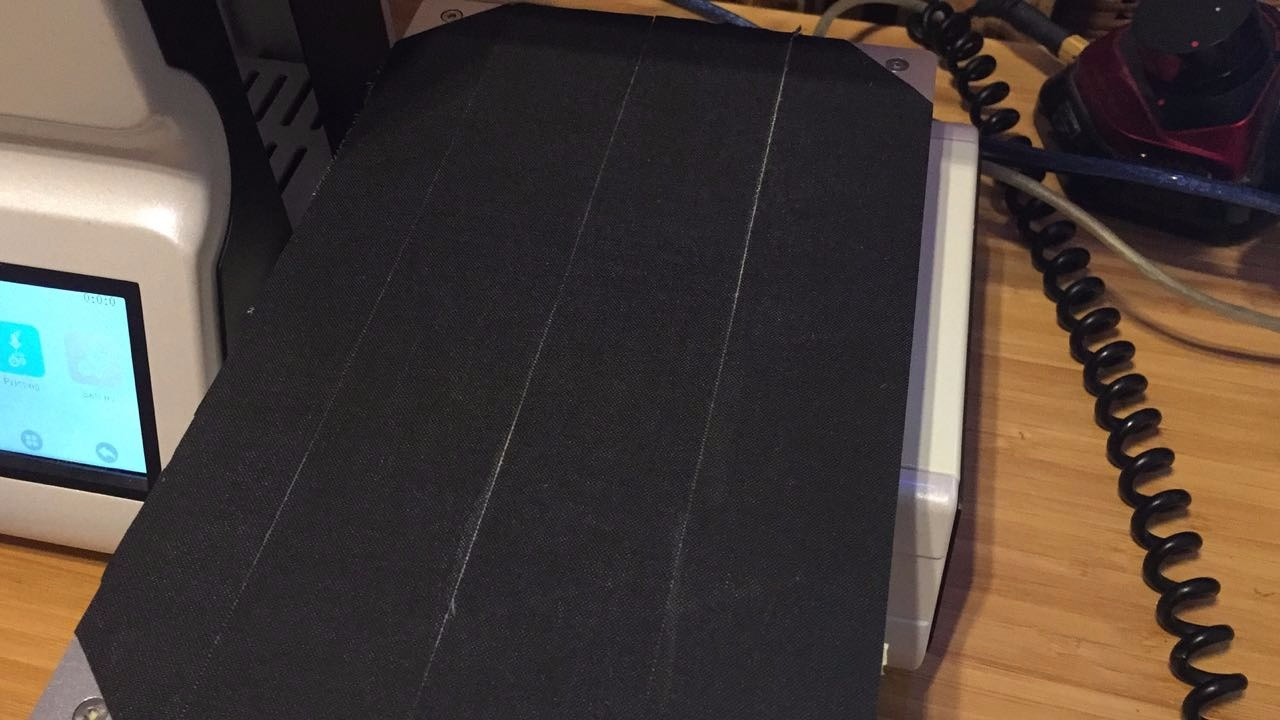

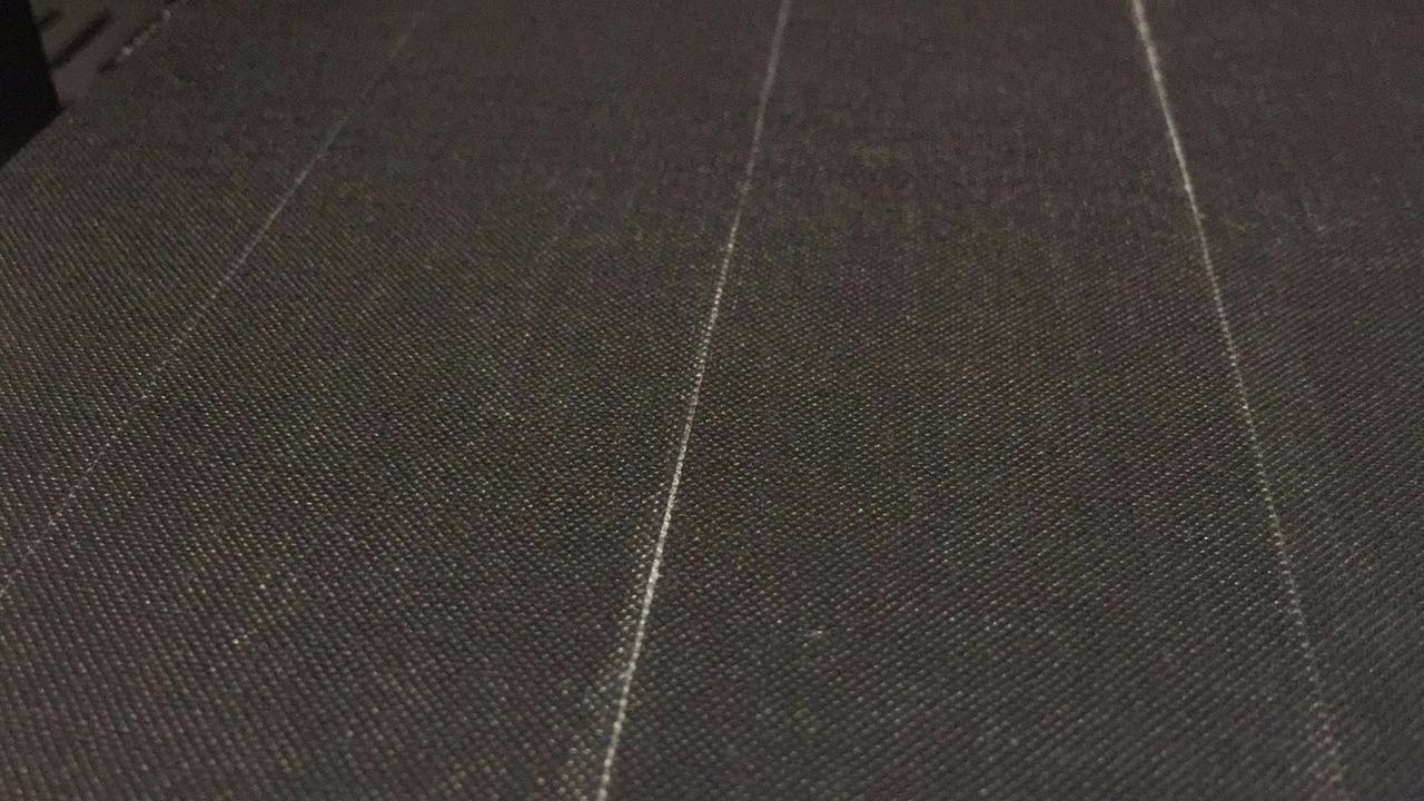

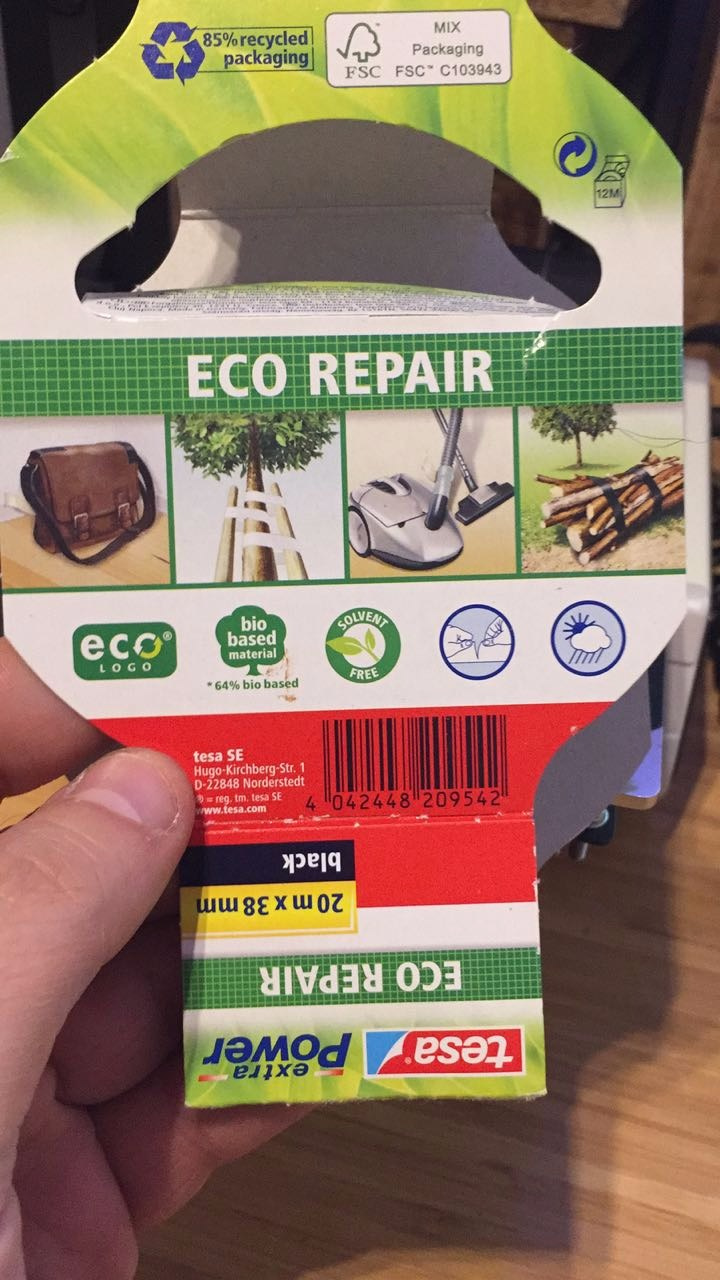

Just purchased today this duct tape (textil based) that seems to be very good if you print with cold bed.
Still testing but it looks promising,
(Duineuk) #94
I need a heated bed for PETG, and it helps prevent warping with PLA. That said, I used the basic blue painters’ tape on my old Printrbot (no heat) and it works well enough,
(Pixelchain) #95
The second printer I have doesn’t have a heated bed (it is a small one that I keep on my desk).
The problem I have with painter’s tape is that it gets broken really easy and sometimes, for large objects, the tape goes off with the objects. This one is very resistant and it sticks fairly well, but the black one leaves a little bit of markings on the object.
So, I will go back to blue tape :slight_smile:

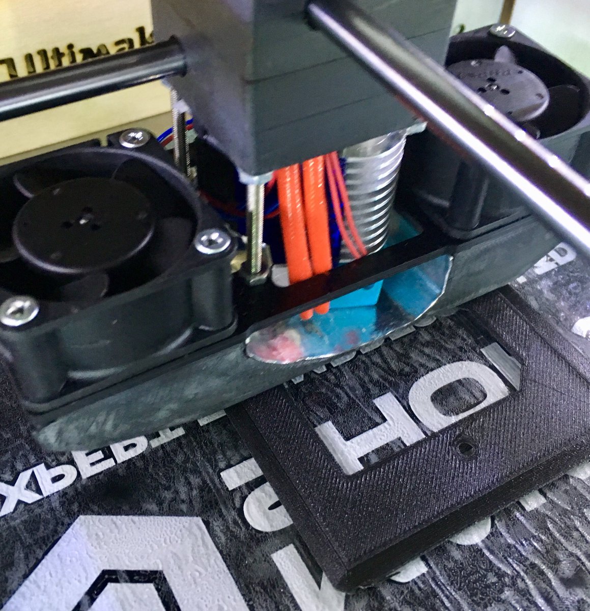

I’ve found the best solution is to use a build surface. I didn’t like tape so have used a mix of Buildtak and similar. I currently use a cheap Chinese one which works pretty well.
One sheet of a plastic with a texture which helps with sticking. Usually only need to print PLA at around 40 degree heated bed.
PEI Is believed by most to be the best however I’ve not had the best results with it but need to try again.
