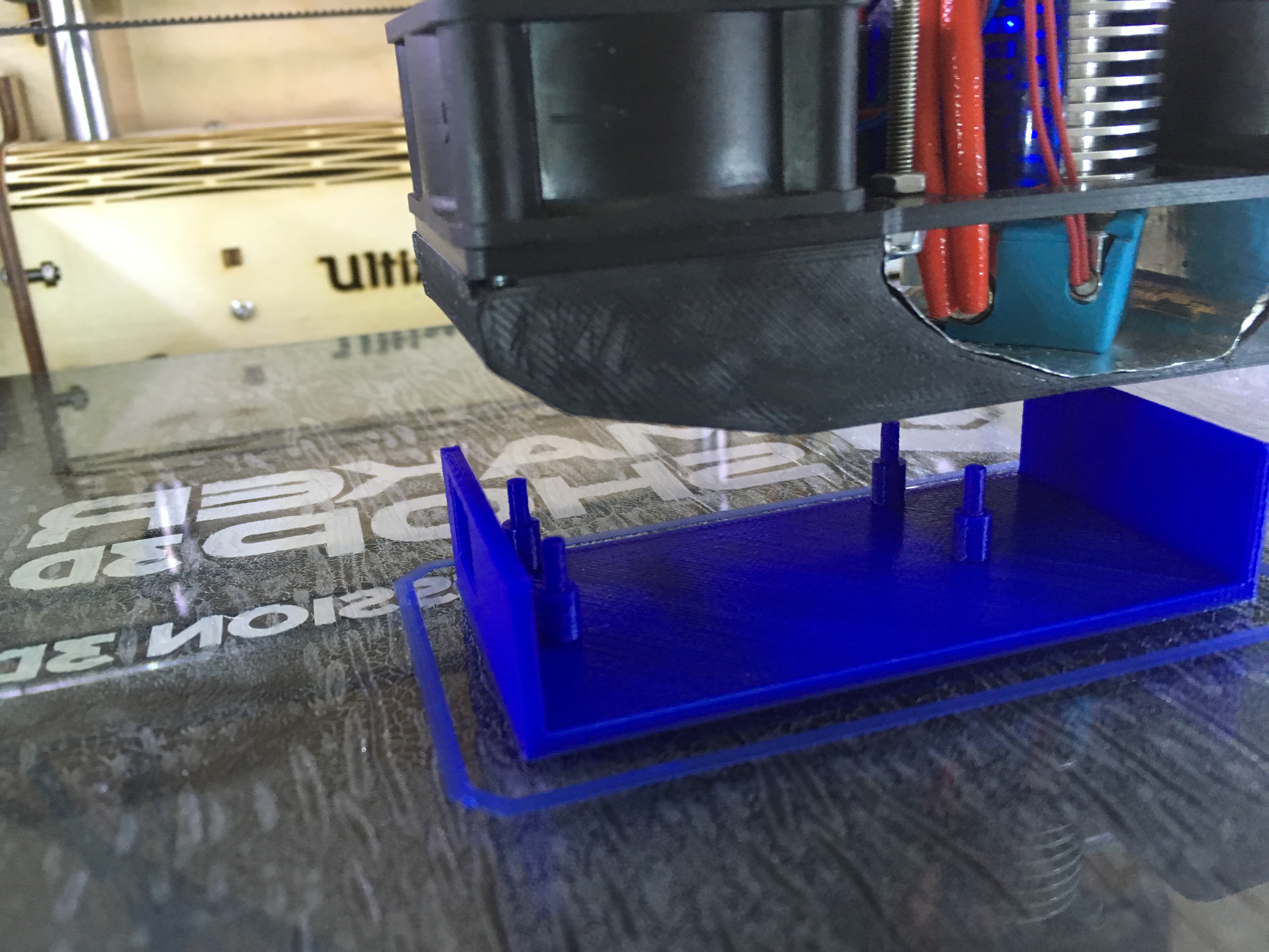

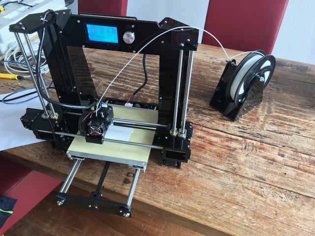

Got my 3d printer up and running… Was easy to asemble the net A6.
Now setup for printing a lot of enclosures.
Don’t forget usual precautions, and ensure your firmware has thermal protection.
You don’t want to get this…

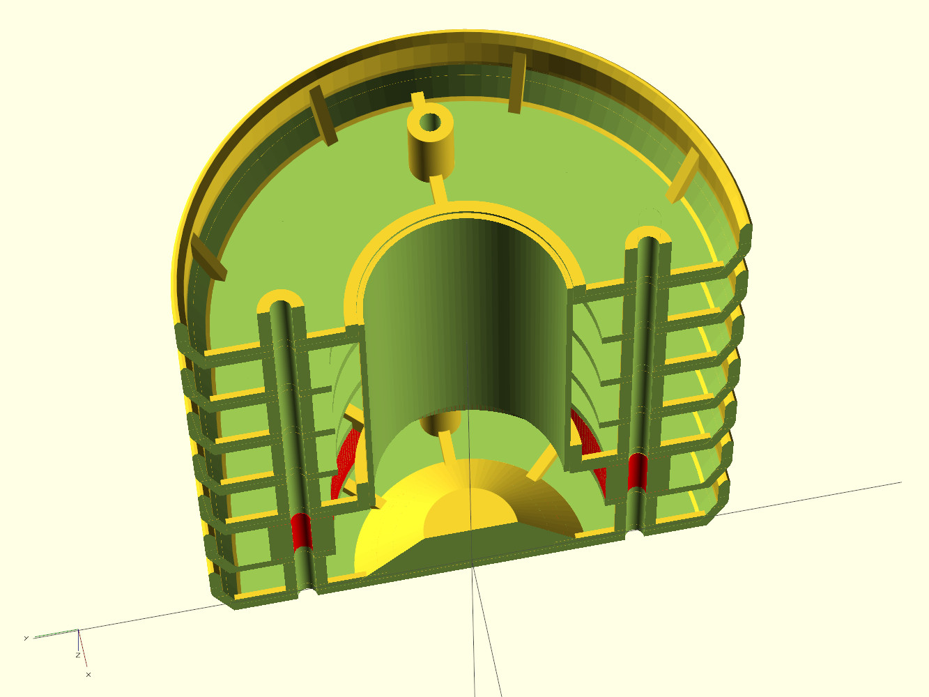

Hello

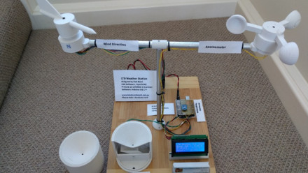

If you looking for an encloser for putting your sensors outdoor?
I found this : https://github.com/apollo-ng/DIY-Stevenson-Screen
good colour

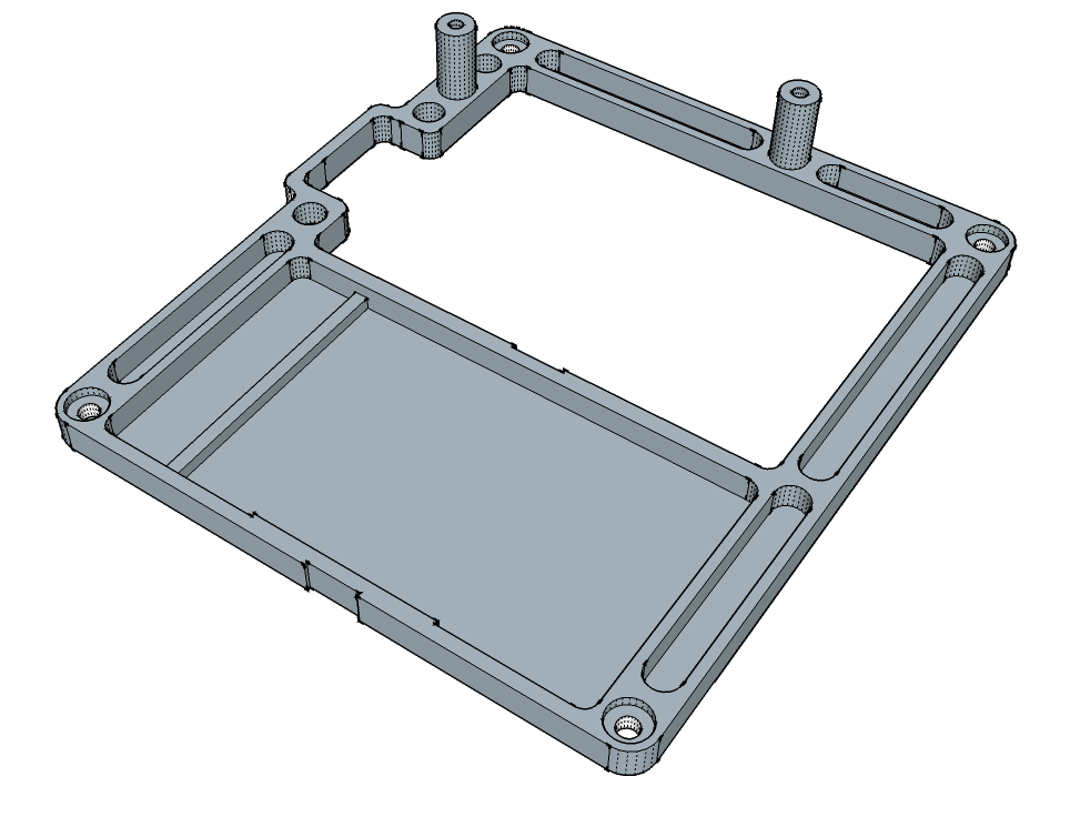

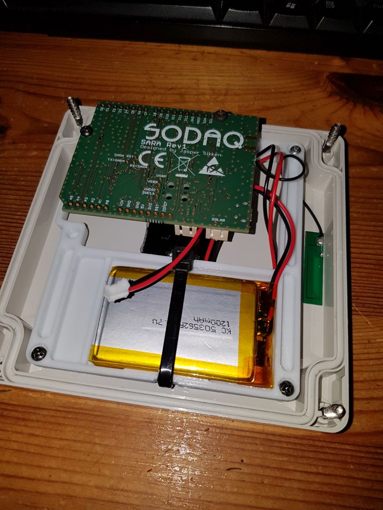

Today I designed this bracket to hold a node and a battery inside a enclosure using Sketchup.
Printing this weekend…
Just a heads up, The ANET Printers sometimes have the thermal runaway protection disabled in firmware. I replaced the firmware and some controller parts when I got mine 2 years ago.

You really should give up on Sketchup…
It is a very nice tool, but not for 3D printing.
There are quite some issues, the main one is that it easily generates non-manifold models.
For functional parts I highly recommend Fusion 360 (Free for hobby/non-commercial use).

And the result after installation:
