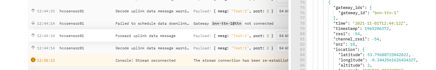

I have another issue that has just popped up whilst making the aforementioned test device. I know it’s ‘fix one at a time’ but this issue is now stopping my investigation.
I have programmed a Heltec Wifi Lora 32 using LMIC-node as an OTAA device (NOT using V2 keys). The LMIC-node code is unchanged apart from the join keys etc.
The V3 console is seeing the JOIN_REQUEST then telling me the gateway is not connected and the JOIN_ACCEPT is, therefore, not being sent to the test device. So it tries over and over to join.
You can see, on the right, the gateway name bnn-ttn-1 but the console has added @ttn.
The gateway page shows messages are received by the gateway and the regular status messages being sent to tnn.

I don’t think the Heltec has anything to do with the console saying my gateway is not connected. I’m using the LMIC-node code not the Heltec Lora code. I got the same thing with my fake hccsensor01 which is RPi+Dragino HAT based. The message received by TTN had the correct gateway id but the downlink error message on the console had the @ttn tennant added. This is a new phenomenon it has never happened before today. I know we are just out of halloween but … LOL
