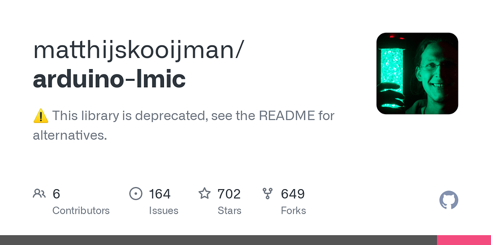

This is the last version that Matt released but he has closed the archive now.
I used previous releases in the past and have used this version. The preferred version which is more compatible is this:
I’ve used up to 3.3.0 and am in the process of testing 4.0.0. It requires a Serious Geek Bee to set the library up to allow it to fit in to a Pro Mini / Nano and even then with the sensors you use it may not fit on the device, but let’s not worry about that now.
