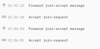

'accept join-request' then the 'Forward join-accept message' loop

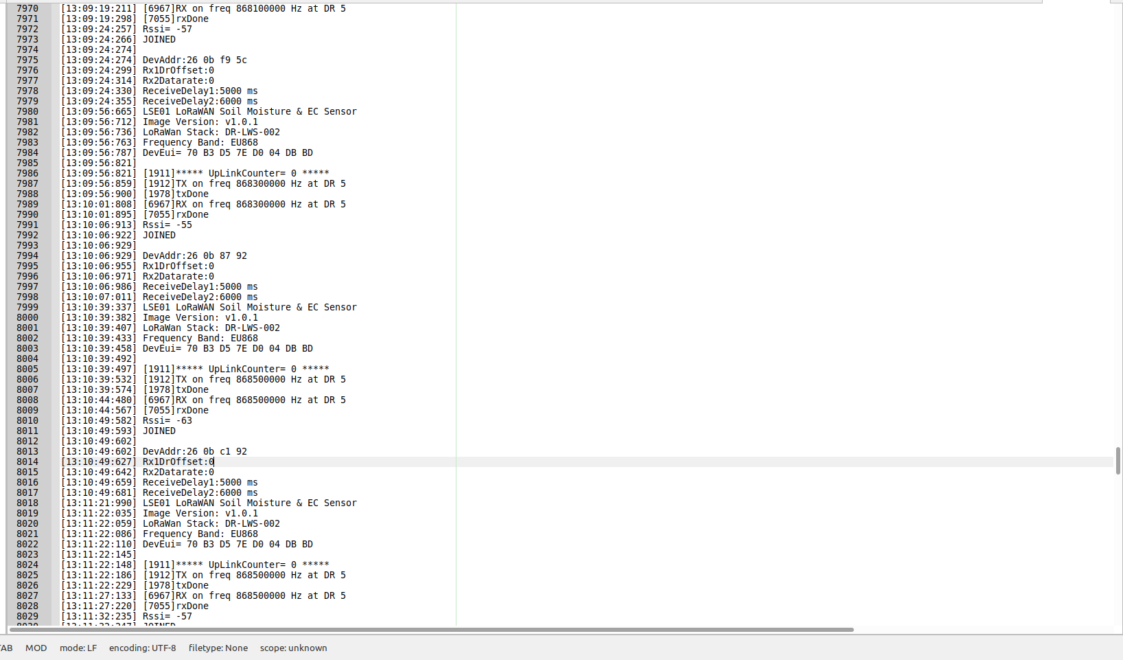

Good morning,
Is there any one who could solve the mentioned problem. It made me disappointed. I see always forward join accept message. Would you please help me?
1- more or less from december 2021 we have this problem
2- I reset the devEUI and all other parameters in lorawan node
3- I tried ABP
Many thanks,
Screenshot from 2022-03-10 12-44-52
  1. is roughly at the time there was a change for the V2 gateways. Is your node able to receive the downlink join-accept?
Screenshot from 2022-03-10 13-56-48

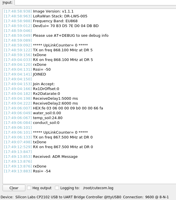

Sorry, can’t read the small text in this screen shot. For text cut-and-paste it to a message (use </> to format), don’t use pictures.
imho the firmware version of your LSE01 is rather old. I would recommend an update to 1.1.4 first.
Thanks, but As @wolfp said I upgraded the firmware to the latest possible version (1.1.1 as it is a LSE01 sensor we bought it in 2020 and its main-board doesn't support version 1.1.4 as I tried it too). But problem didn't solved.
![Screenshot from 2022-03-10 17-55-13|1000x493](upload://hcNr5PzhlA4RAn0STqUBmVwlrqW.png)
![Screenshot from 2022-03-10 17-54-01|1000x562](upload://h4HqNwgitnse6OhC9s5xstisE3y.png)
Its also possible to hold ctrl+move mouse scroll to maximize web page. I tried to do as you said, Please let me know the screenshot is visible.
The second screen shot is clearly some text that if you can’t copy & paste off the CuteCom screen, you could copy & paste out of the cutecom.log.
The primary reason for getting text formatted with </> is that we need to see the serial log for the device for the loop - neither screen shot shows any form of loop.

[18:16:18:577] rxDone
[18:16:18:588] Rssi= -50
[18:16:18:600] JOINED
[18:16:18:608]
[18:16:18:608] Join Accept:
[18:16:18:624] Rx1DrOffset:0
[18:16:18:640] Rx2Datarate:0
[18:16:18:656] ReceiveDelay1:5000 ms
[18:16:18:680] ReceiveDelay2:6000 ms
[18:16:50:113] Hardware version:LSN50 V2.0
[18:16:50:948] LSE01 LoRaWAN Soil Moisture & EC Sensor
[18:16:50:994] Image Version: v1.1.1
[18:16:51:019] LoRaWan Stack: DR-LWS-005
[18:16:51:046] Frequency Band: EU868
[18:16:51:070] DevEui= 70 B3 D5 7E D0 04 DB BD
[18:16:51:104]
[18:16:51:104] Please use AT+DEBUG to see debug info
[18:16:51:148]
[18:16:51:148] ***** UpLinkCounter= 0 *****
[18:16:51:179] TX on freq 868.500 MHz at DR 5
[18:16:51:216] txDone
[18:16:56:091] RX on freq 868.500 MHz at DR 5
[18:16:56:177] rxDone
[18:16:56:190] Rssi= -51
[18:16:56:201] JOINED
[18:16:56:208]
[18:16:56:208] Join Accept:
[18:16:56:224] Rx1DrOffset:0
[18:16:56:240] Rx2Datarate:0
[18:16:56:255] ReceiveDelay1:5000 ms
[18:16:56:279] ReceiveDelay2:6000 ms
[18:17:02:565] HEX:fe 03 06 00 00 0a 0d 00 00 f6 9a
[18:17:02:610] water_soil:0.00
[18:17:02:626] temp_soil:25.73
[18:17:02:644] conduct_soil:0
[18:17:02:660]
[18:17:02:660] ***** UpLinkCounter= 0 *****
[18:17:02:693] TX on freq 868.300 MHz at DR 0
[18:17:04:056] txDone
[18:17:09:087] RX on freq 868.300 MHz at DR 0
[18:17:10:405]
[18:17:10:408] Received: ADR Message
[18:17:10:434]
[18:17:10:434] rxDone
[18:17:10:443] Rssi= -54
