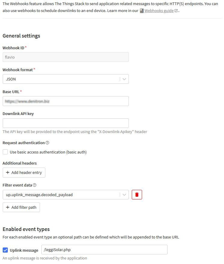

in my application each uplink event raised by an end-node is connected to a webhook which transmits a request to my database server. The request contains JSON formatted information as you pointed out to me.
Currently I have chosen to apply the “up.uplink_message.decoded_payload” filter, however this filter generates JSON content that does not report the dev_eui of the device. I see the gateway EUIs but not the end node one. I’ve tried other available filters but I haven’t found one that also includes the dev_eui.
I’m probably making some mistake but I don’t understand where I’m wrong.
immagine
Sorry to be blunt, not sorry, but you’ve put a filter on the event data and you’re not getting the fields you need. :wink:
Perhaps remove the filter and then put a filter back once you have what you need and debug from there?
However as it’s a JSON path, you can’t have just the end_device_ids and decoded_payload.
I’d strongly recommend keeping the f_cnt as well - always useful for figuring out if a device has restarted.
wow! You were right to be blunt, it helped me :wink:
I had the solution under my eyes and I didn’t see it, in fact by removing any filter I got a much bigger JSON file but with much more information, including the much desired dev_eui
You helped me solve a problem, I also thank you for your patience :smiley: :+1:
