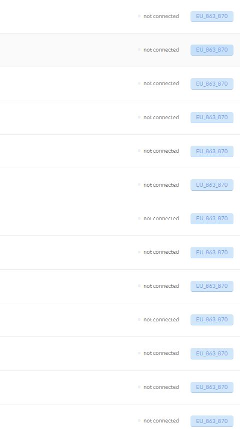

All of the gateways show "not connected" (offline) in TTN Console
Anyone got a problem on the community section, that all off the gateway shows not connected , approx 2 days ago ? Using ttn packet forwarder in legacy mode

The team is on to it; from #ops in Slack:
htdvisser 10:44 AM
Sounds like the console lost connection to the NOC
(To get access to Slack, see https://account.thethingsnetwork.org/)
And all fine again 5 minutes after I posted the above.
Just for future reference, from Slack today:
@htdvisser 2019-12-23 9:15 AM
The connected indicator, last seen and received/transmitted messages in the console are indeed unreliable. They may indicate that a gateway is offline, while it is in fact online. This is a known issue that will not be fixed.
@htdvisser 10:08 AM
V3 will work differently indeed. In v2 all Routers send gateway status info to a central “NOC”, from where the Console can request it. The v2 NOC is in a different region than the Routers, which seems to be causing trouble (just as cross-region traffic has issues). In v3 clusters are more independent, so Consoles in a cluster can request gateway information directly from the Gateway Server in that same cluster, which makes things much more reliable.
