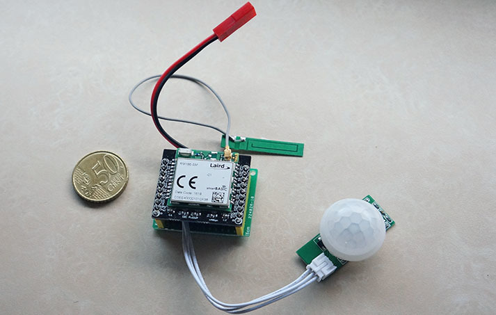

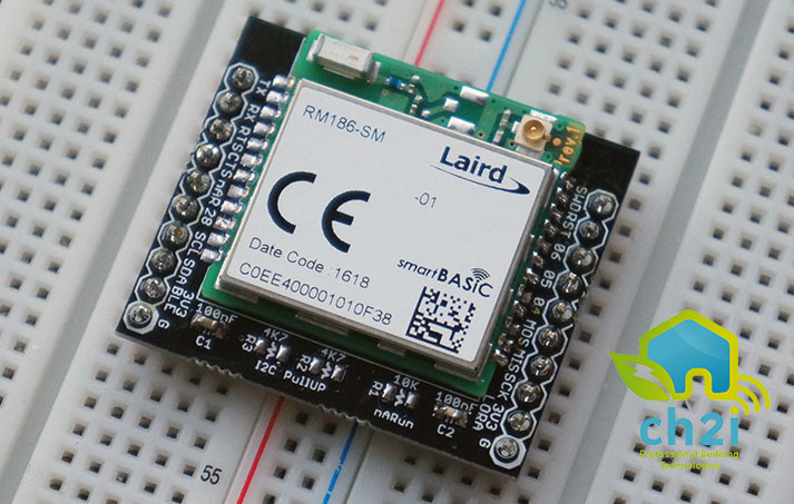

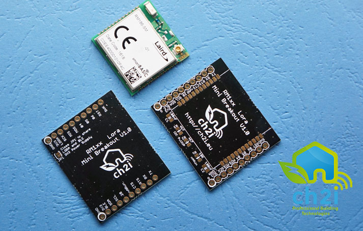

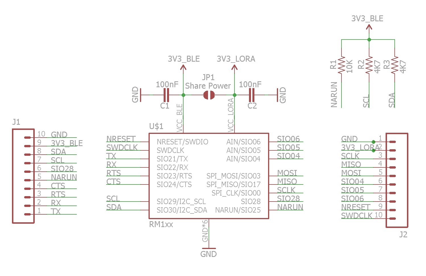

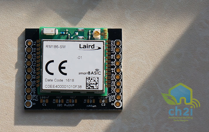

early ' Sinterklaas' present arrived yesterday , the new CH2I RM186/191 adapterboards :sunglasses:
(Gonzalo Casas) #211
Fantastic! @Charles: is there a pcbs.io link available?
#212
you can order them here
I'll test this adapterboard today

So what do you have there? Laird + is that a Pololu step up/down (S7V8A?) + FTDI?
#216

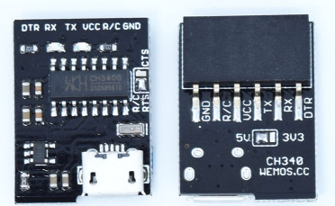

  • Pololu 3.3V Step-Up/Step-Down Voltage Regulator S7V8F3
  • FTDI Basic Breakout USB-TTL 6 PIN 3.3/5V
#217
@BoRRoZ
Very nice pictures, thanks for them :wink:
And boards are working fine ?
just received these $2 FTDI, awesome
#218
Hi Charles, yes the boards are perfect.
Goldplated and easy to solder (even with my eyes :wink:)
now if somebody can make a part for fritzing from your adapterplate ...

  • credits for the adapter PCB go to Charles - CH2I

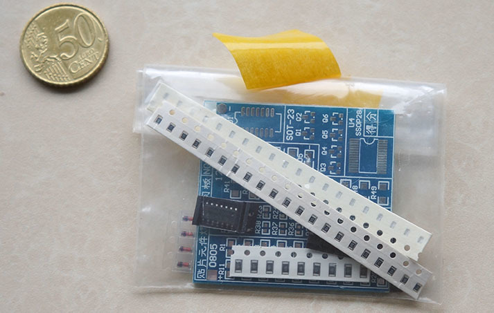

as a 'newbie' on soldering.. be very very carefull.. its not that easy :wink:
#223
I'm thinking of ordering some test boards to get some experience with this kind of precise soldering.
Do you have any advice for me?
Worst case scenario I break a €20 board, so will see what happens :wink:

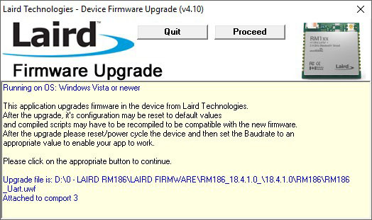

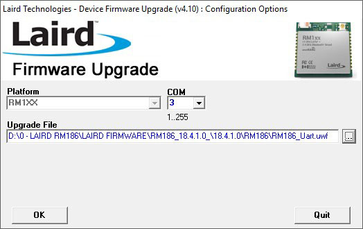

updating firmware LAIRD RM186 :
connect your RM186 adapterboard with usb serial ( I used this one but others will do )
serial/adapter
Tx Rx
Rx Tx
RTS CTS
DTR RTS
3V3 BLE/LORA
GND 1/8/11/14/21/24
after soldering and wiring check with the terminal program if you can communicate with the module and check the current firmware.
attention switch the usb serial converter to 3V3 logic and make sure that the Vcc of the module is 3v3 !
so don't feed it direct from your PC

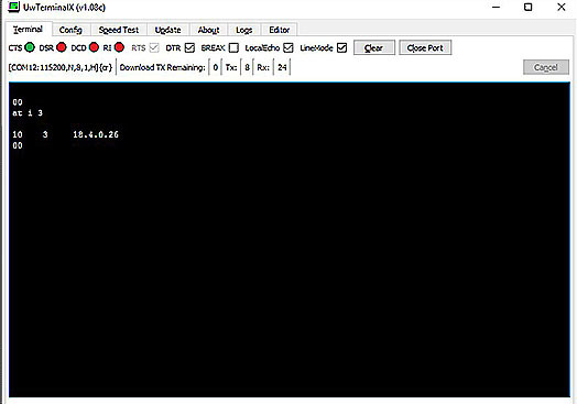

now check communication from within the terminal program:
AT I 3
the module answers with the firmware version, here 18.4.0.26

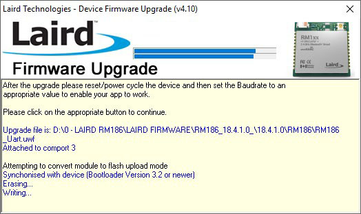

create an account (free) at the LAIRD site where you can check for the latest firmware, download the zip file.

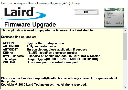

inside you'll find RM1xxUartFwUpgrade.exe the tool to upload the new firmware, which is alsoo included.
at this moment 18.4.1.0
now start this tool.. and point to the new firmware image

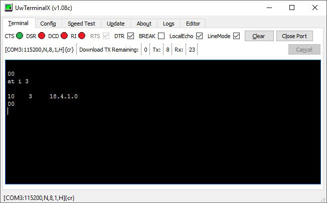

finally start your terminal again
and you're up to date
