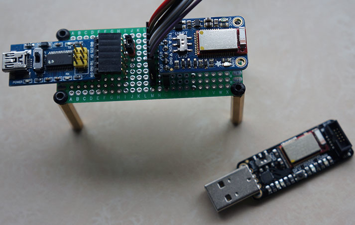

To ‘see’ something I bought a BLE sniffer
