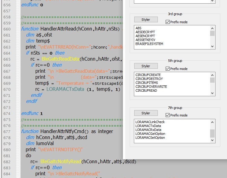

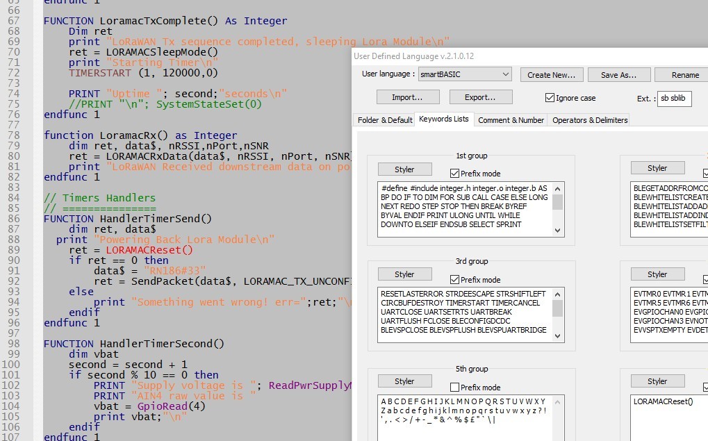

Did someone maybe made a NOTEPAD ++ language file for LAIRD smartBasic, which includes the LoRa commands for the RM186 and would like to share this ?
I am struggling to get it right. :sunglasses:
You temporarily get them from https://www.dropbox.com/s/30bf5c40qizi5a7/RM1xx_Notepad%2B%2B.zip?dl=0
tnx, but that’s not complete with LORA commands , its the one from the LAIRD site.
But I fixed it today myself
:innocent:
What functions are missing?
LORAMACSleepMode
LORAMACReset
LORAMACJoin
LORAMACLinkCheck
LORAMACTxData
LORAMACRxData
LORAMACGetOption
LORAMACSetOption
but I have it working now, only some fine tuning :wink:
All those functions are in the linked file, I’m assuming notepad++ is case sensitive (I don’t use it)? From the file I attached are functions such as: GPIOUNASSIGNEVENT, LORAMACSLEEPMODE, LORAMACRESET, LORAMACJOIN (notice they’re all in upper case). All the LoRaMAC functions on the RM1xx series are included in that zip however.
sorry then i’ve missed that, will have another look :sunglasses:
  • you were right

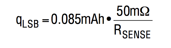

I’m trying to use the LTC2941 Coulomb counter / Battery gauge on the development kit. I’ve seen the Laird example and can see the counter value increasing however I’m not sure what it’s actually measuring in real terms.
The manual refers to the LTC2941 datasheet but I’m struggling to apply that information to the development kit (ie sense resistor on kit seems to be 1Ω)
Any tips would be most welcome. Maybe @BWhitten or someone who has used ICs like this before?
EDIT: I think I figured it out, going by the formula in the datasheet
and replacing Rsense with 1Ī© I think each ā€œcountā€ measured on the kit reflects 4.25 μAh
If someone can confirm this I’d be very grateful.

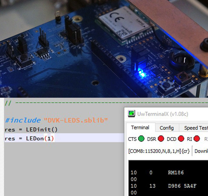

I am allready happy that I can turn a led on and off through SPI :sunglasses:
