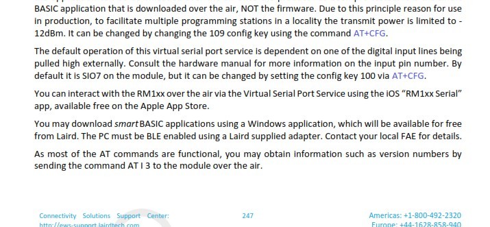

How can I communicate from my PC/Laptop (win10) with an RM186 via BLE ?
-what software/hardware do I need ?
-is it possible to ā€˜upload’ smartbasic programs this way ?
-what is a ā€˜laird supplied’ adapter ? is that diffent then ā€˜normal’ BT adapters ?
this is from the ā€˜smartBASIC Extensions v1.0 - RM1xx’ documentation :
  • update
UwTerminalX v1.06 for Windows, Linux and Mac
News from Laird support regarding the virtual serial port:
I’m pretty sure this means smartBASIC uploads over bluetooth are not possible, however I’m following up with support to make sure.

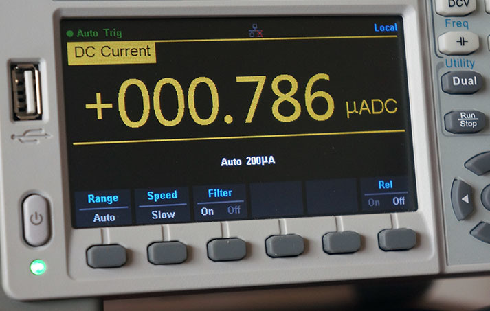

deepsleep power consumption RM 186
uartclose()
rc = LORAMACSleepMode()
rc = SystemStateSet(0)
