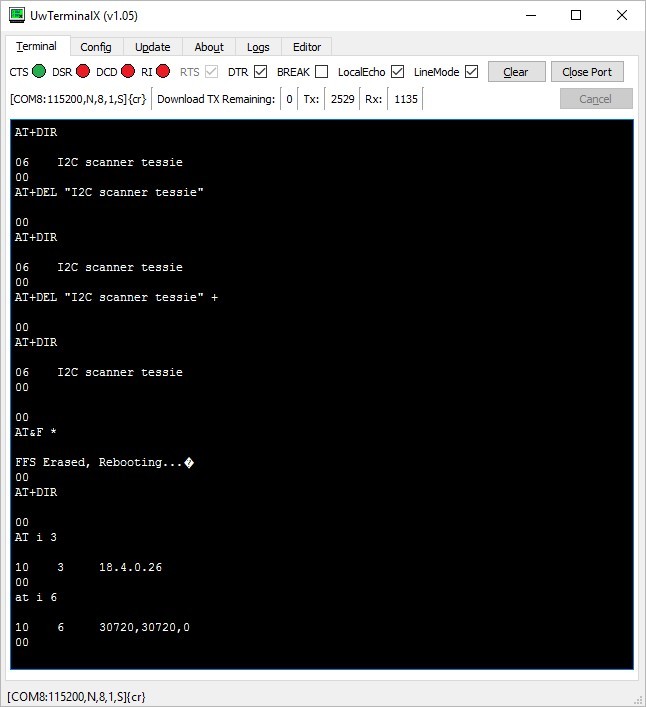

trying to delete a file from the flash file system with AT+DEL âxxxxâ
It didnât work, finally I used AT&F * , what went wrong here ?
I really donât know why at+del didnât work in there.
I usually keep my filenames without spaces because then I can run them by just typing the name, however Iâve just tried your example and in my case at+del had no issues with it.
That said because at+del doesnât really free anything - itâs rather pointless other than for cosmetic reasons
- I tend to go for the:
atz
at&f 1
which is just a bit more precise than nuking everything with at&f *

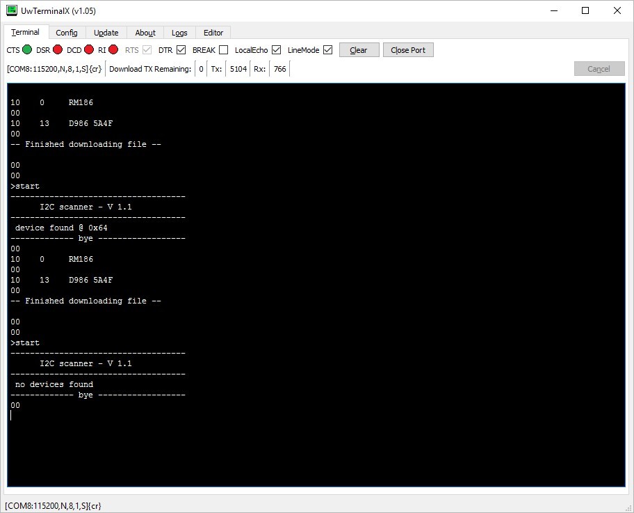

I2C busscanner for RM186
true, an external mem maybe ?
Thatâs fancy
I was just probing by trying a read from reg 0x0:

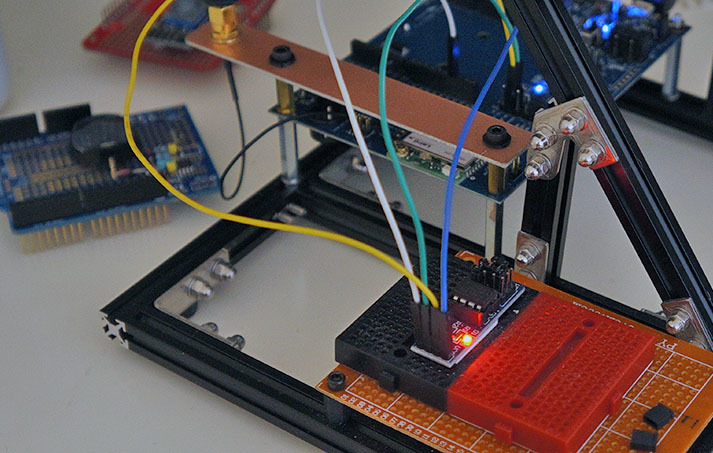

I thought about using an external memory to store the LoRaWAN configuration, and the ultra-cheap ($0.50) DS3231 RTC module Iâm using conveniently also has an Atmel I2C EEPROM but unfortunately those configurations need to be set from interactive (ie AT) mode.
I donât see a way to tell the RM186 to read the settings from an external EEPROM and set the keys from that.
The setup on the picture with the mem module, I used to test the I2C scanner.
But off course I will try to write a âshadowâ register to it.
And after a coldstart this shadowregister is red and written to the RM186⌠in theory
I donât see why it canât be done⌠the only trick is to sync your RTC, which can be done
with your system clock when connected.
