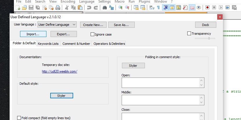

Somethings else, is there a notepad++ syntax definition available for this device like there is for the Bluetooth modules? (One including the Lora specific keywords)

Yeh that file will be available in future releases.

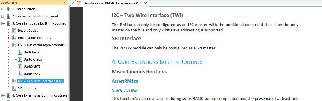

but in the smartBasic extensions documentation I can’t find anything:
so how can we connect an I2C device ? do you have to adapt the firmware…
The RM1XX smartBASIC Extensions manual is not enough to understand the platform, refer also to the smartBASIC Core user guide which explains many of the common things across the RMXXX and BLXXX modules, including I2C:
Probably an oversight that this manual isn’t linked from RM186 page, but it is linked from the Bluetooth modules (e.g. BL600,620…).

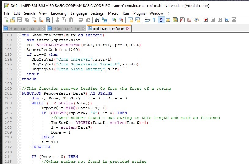

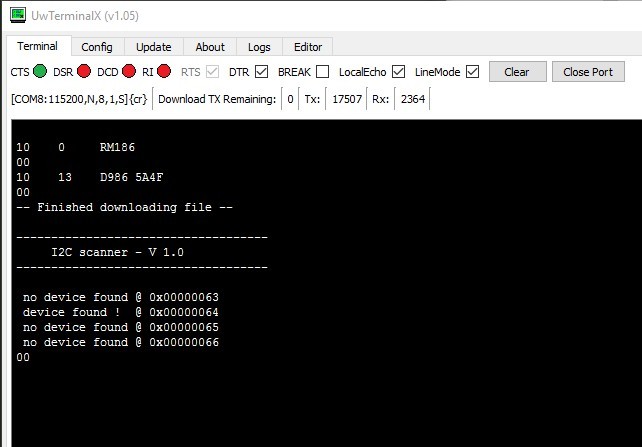

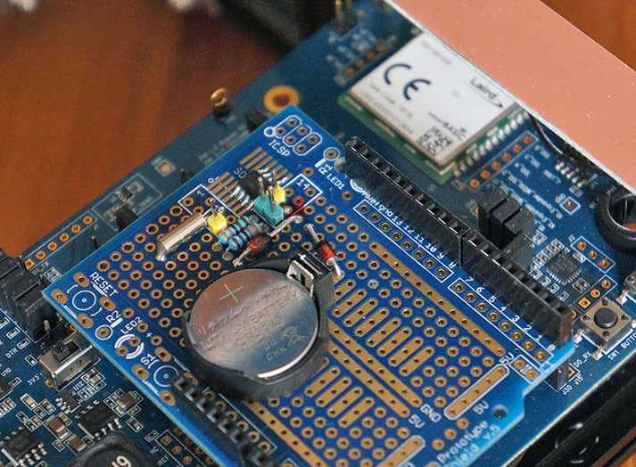

I am trying to let the rm186 talk to a RTC via I2C bus.
For the Arduino and the ESP you have that handy tool 'I2C scanner, so you can see what adresses are in use by the bus (and if your device is ‘seen’)
I couldn’t find it for the rm186 so I am trying to make it… my first ever smartBASIC program
Sure I2C scanner is a must
Cool what RTC is that? I was actually working on some code for the DS3231
The more the merrier!
tnx, its a (pincompatible) 1337

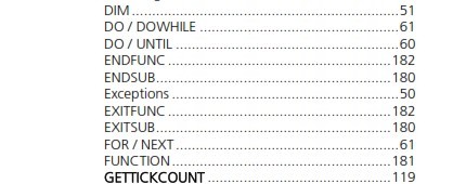

I was searching for endsub and exitsub … the page referred to in the index(180) do not excist (yet).
but I found the info in the same manual on page 176
