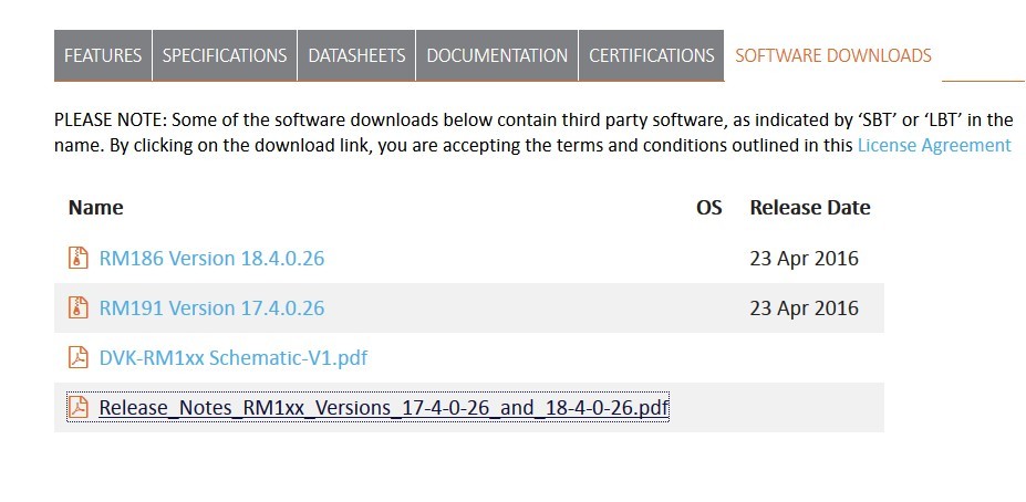

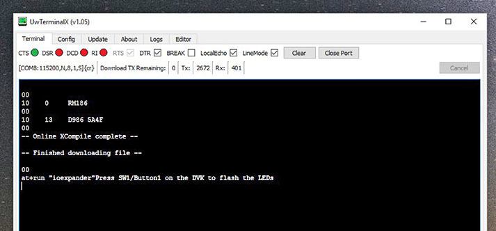

The cloud compiler works, but i want to compile locally, and it seems that I’m missing XComp_RM186_D986_5A4F.exe in the folder compilers/
And I can’t register online, I assumed I’ll have to do that before getting this compiler.
You can just type ioexpander (or any application filename) in interactive mode to run the application you loaded, no need for at+run… (unless your application filename contains spaces)
yes tnx, I cannot find XComp_RM186_D986_5A4F.exe … that file is the local compiler.

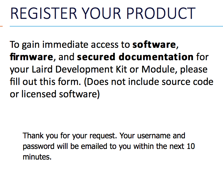

Yes you need to be logged in to get the full SDK package.
Have you tried to register at http://www.lairdtech.com/support/product-support-center/embedded-wireless/embedded-wireless-software/register-your
I just tried for a friend, filled in the registration form and got it straight away
I’ll tried it 4 times… on that page.
filled in everything correct, but it seems to ‘hang’ on the reCAPTCHA.
UPDATE : to register I had to switch off Ghostery
I completely forgot
When form asks technology interested too, there is no mention on LORA anywhere!
I’m still waiting the email with my username/password for 30 minutes now
that’s why I marked …uh… something else
well that seemed to help
OK I found the compiler file … and I can compile locally too now

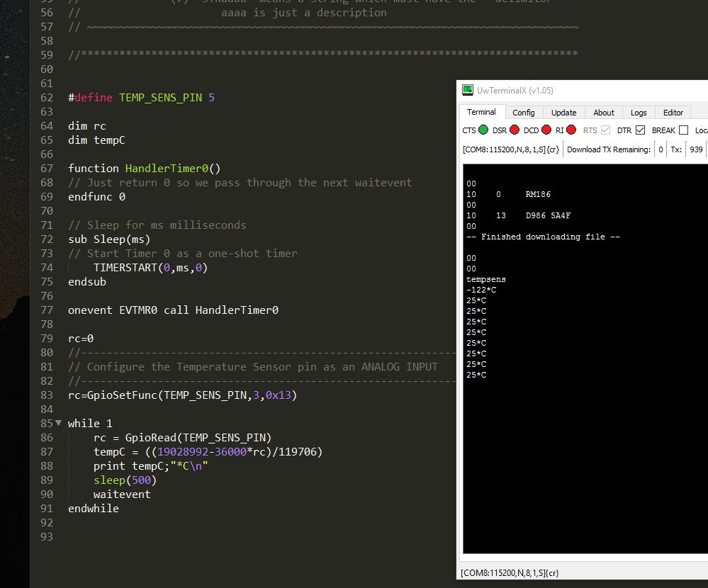

I’m using Sublime Text to figure out why in the world you would put an LM20 analog tempsensor on a devboard
Sublime Text is a must have

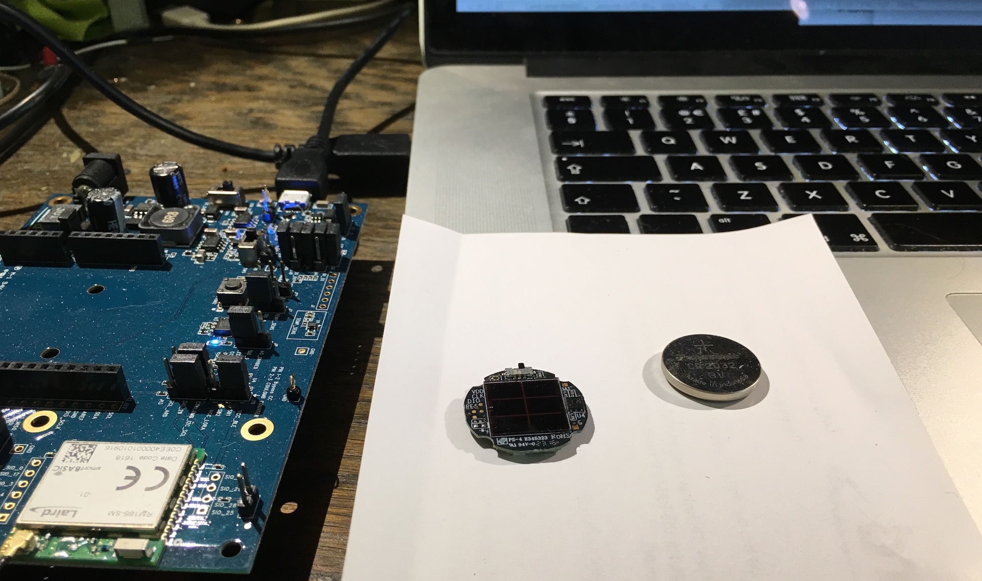

My RM186 kit is collating humidity/temperature data from several (currently 5) of these tiny coin-sized solar powered Bluetooth LE beacons for uploading to TTN.
Sensor data arrives inside Bluetooth LE advertising packets, very much like how iBeacons work.
The CR2032 battery is for scale only, these Cypress energy harvesting beacons contain no battery, they’re purely solar powered but still work indoors, for example near a lamp or window.
