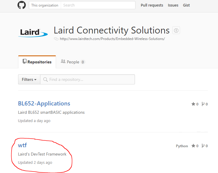

look below on github

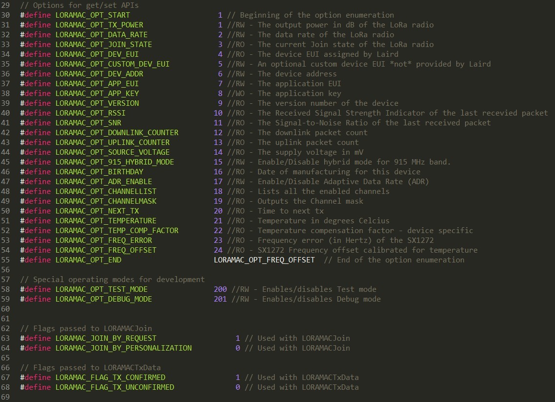

@BWhitten : any idea where we can find RM1xx-defs.h?
The https://github.com/LairdCP/RM1xx-Applications/blob/master/cmd.loramac.rm1xx.sb sample requires this header file but itâs not part of the repository
I tried to register here http://www.lairdtech.com/support/product-support-center/embedded-wireless/embedded-wireless-software/register-your to download the SDK but the form keeps insisting that a âfield is requiredâ while everything is filled in.
Thanks
@dirkvm: This header file should be in the firmware release package for the module.
If you can try another browser or device. Failing that drop them a line on the support portal, the website can be a little temperamental. ![]()
Thanks @BWhitten Tried both Firefox and Chrome without success, dropped them a note yesterday and today
Rename to .h
RM1xx-defs.h.pdf (3.7 KB)
