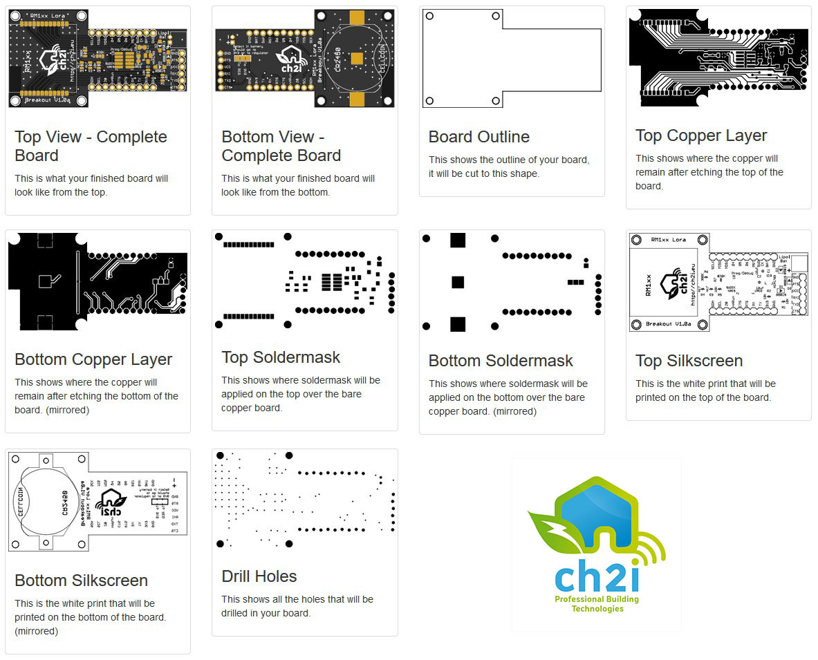

do you put it on OSHpark or tindie?
#23
@ursm
you can order PCB boards directly to PCBs.io here they give me back some fees on my boards design ordered by interested users on their site.
I love OSHPark, but they don't have this kind of business model (I already asked them) and a lot of people ordered boards I designed at OSHPark without any return on me.
But don'y worry you can still order to OSHPark, just download the board file and submit it to OSHPark.
#24
@Charles hi Charles
I've no problem ordering at PCBs.io to give you something back for your great work!
#25
@ursm
thanks, it's better if you wait until tomorrow, I need to change a mounting hole in design ;-(
#26
@Charles I'll be patient until you gave the signal :wink: We have also to wait for the RM-module.
Are 1206 components to big for your layout???
#27
Ok guys, version 1.0a is out no more copper on mounting holes, and also added via for ground plane under RM1xx module
I updated all links and pictures in this post and on github of course
PCBs.io also
@ursm
yeah 1206 will be difficult and more than this, I'm storing already 0603 and 0805 basic so I've got some duplicate components and having now in 1206 will need me another version which makes me 3 versions for each comps (but I already thought about this)
But 0805 are not so difficult to solder :wink:
