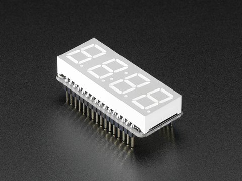

I’ll just be a seven segment FeatherWing so no love lost if I can’t figure out v3
