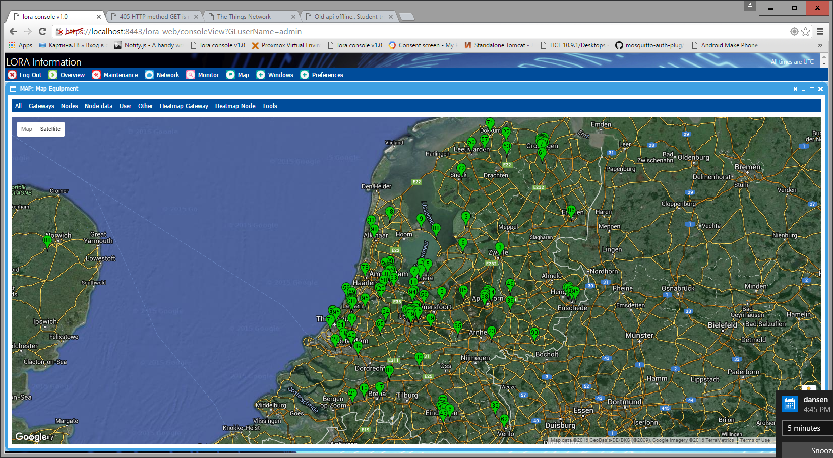

I am little frustrated with the new platform. On the old platform i was just able to get all information from all gateways and nodes which i used to create a nice monitoring system to see the coverage in e.g. Flevoland. I do not own any equipment so i relied on equipment from others to get the data, they shared me the AppKey, With the new approach it looks like i cannot get this data anymore. I am just wondering why we really need to be so paranoic and close all these interfaces. To me the encrypted data part is already sufficient to prevent that someone sees the actual data. I hope that in the short future there will be a solution to get all data via MQTT again. If not then my application server is a dead project.

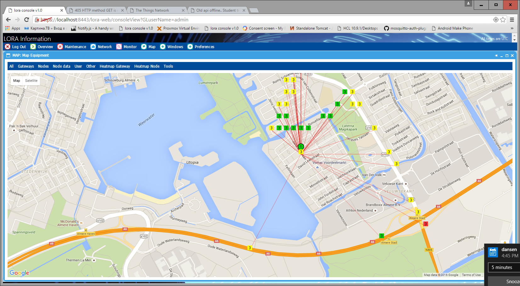

could you explain why gateway info is restricted also? Most important for me are just the gps coordinates and the eui. This way i can calculate the distance between the ‘authorized’ node and the gateway. See my pictures before.

I think that if you want to do some planning of iot nodes in the field it would be interesting if that area is covered by any gateway. I was using the gps coordinates of the gateway to see where there are gateways in the neighbourhood and to see if we have a good signal. We did some war driving in the past so we could draw up a picture i showed before where we calculate the distance of the node towards the gateway and the snr ratio which belongs to that packet. I will have a look if i can use the info you all provided. for the record, i understand the need for security, only disagree that the gateway information is not public available. Anyway thanks for your input
