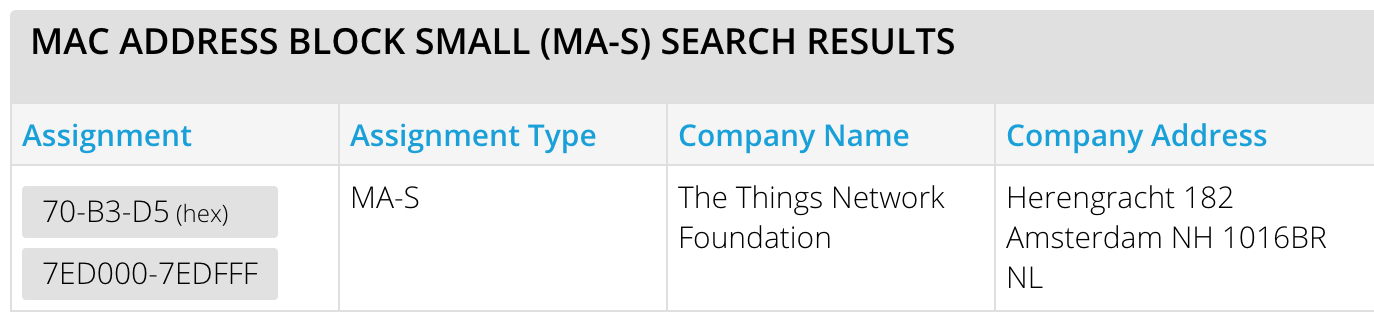

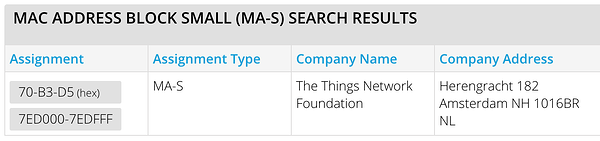

Ah, interesting. Just in case you missed it from the links above, TTN did buy such MA-S block:
This starts with 0x70B3D57ED and does mention an OUI, but it’s not my cup of tea:
Details OUI 70:B3:D5:7E:D Company name The Things Network Foundation Border left 70:B3:D5:7E:D0:00 Border right 70:B3:D5:7E:DF:FF Block size 4,096 Assignment block size MA-S
OK I indeed missed that link -> IEEE is a bit confusing to me. But seems you are right and the MA-S is sufficient.
I noticed TTN in this list as well IEEE MA-S

…though maybe the macaddress.io website always assumes an OUI, so just always shows the first bytes of every block to be the OUI? (I don’t like that they always refer to “MAC Address”. That makes sense given the domain name but maybe the site is not suitable to get proper information for non-MAC address assignments?)
On Welcome to The Public Listing For IEEE Standards Registration Authority I don’t get much details when searching for 70B3D57ED:

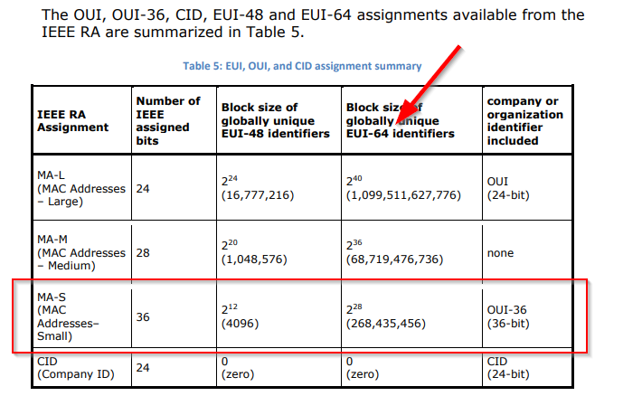

macaddress.io also mentions (refering to MA-S, MA-M, MA-L) the following:
There are currently 3 different size blocks of MAC Addresses available. All three could be used to generate universally administered MAC‌-48 and MAC‌-64.
My interpretation of that: You can use the MA-S to create a MAC-64 / EUI-64. This also is shown in the IEEE RA Guidelines for Use of EUI, OUI, and CID (see Table below)
