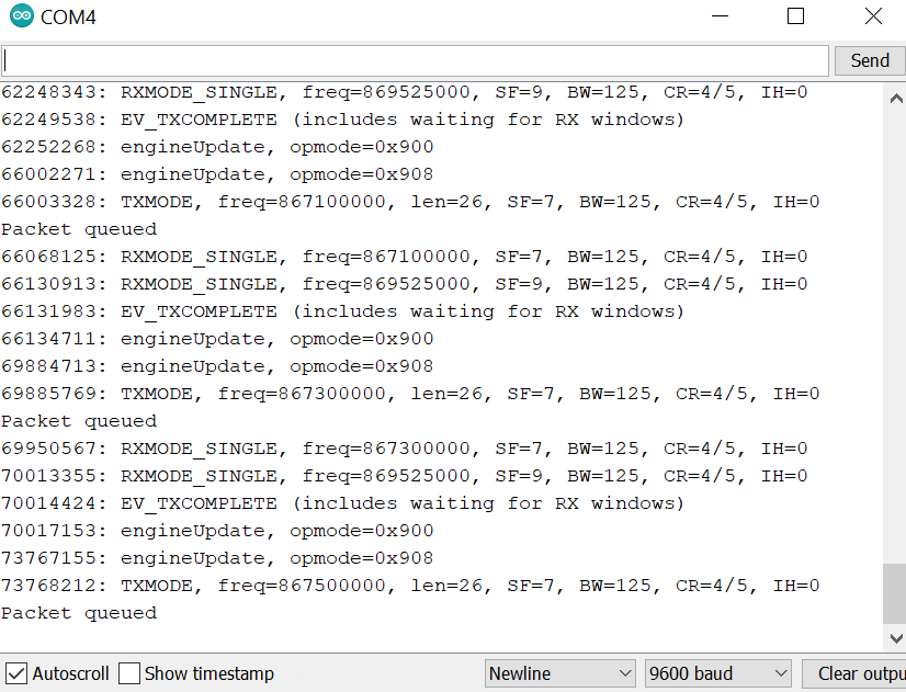

OK, my device is sending “hello world” once a minute. I posted above more details that It outputs in the console. Do you want to re-post it one more time or I don’t understand something…

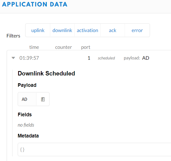

This screenshot you wanted to see?

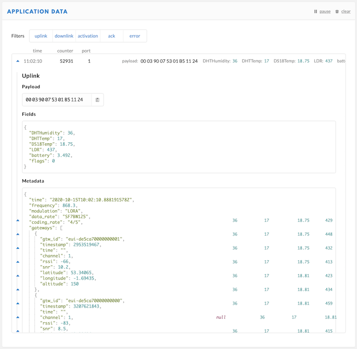

Sorry, no, the TTN console, like this:
Screenshot 2020-10-15 at 11.03.53
This is a device like yours, with a DHT11 and a DS18B20 on it, using the same code base.

This one?
I don’t see any uplink here…
My screen shot says “Uplink”, so that’s a BIG no from me, says Simon Cowell.
There should be a counter entry and it should show the current time so we know the devices is currently uplinking. I am aware you are in Paris, so I’ll translate the timezone info.
But my screenshot says, I don’t have any uplink message received.

No, it shows the first line of the log, I don’t know if you put in a downlink and have an uplink underneath that you didn’t show.

Look at the filters, they are enabled all, to show me all messages, uplink, downlink an so on. I expanded only downlink sheduled message (that you suggested me to test) because there is no other messages to show.

The crop on the screen shot could show an uplink that I can’t see, regardless of filters.
You were asked to verify an uplink here, that is the only test I’ve been interested in for about 1d now:
