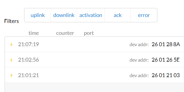

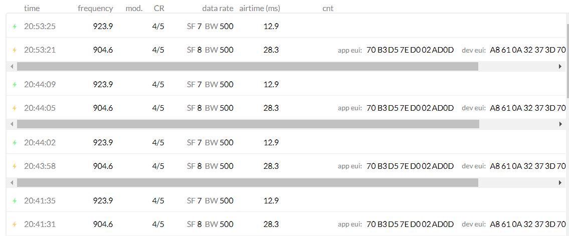

The Gateway traffic on the TTN console only show Join Request (23 byte size) with the correct EUI of my MKRWAN and Join Accepts four seconds after.
The application Data only shows activation messages. The device EUI is correct.

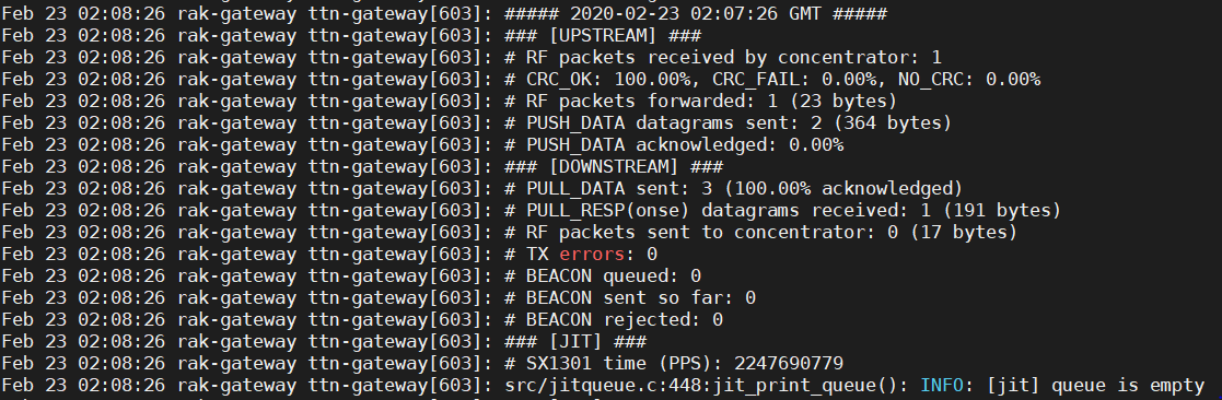

While the gateway logs shows:
