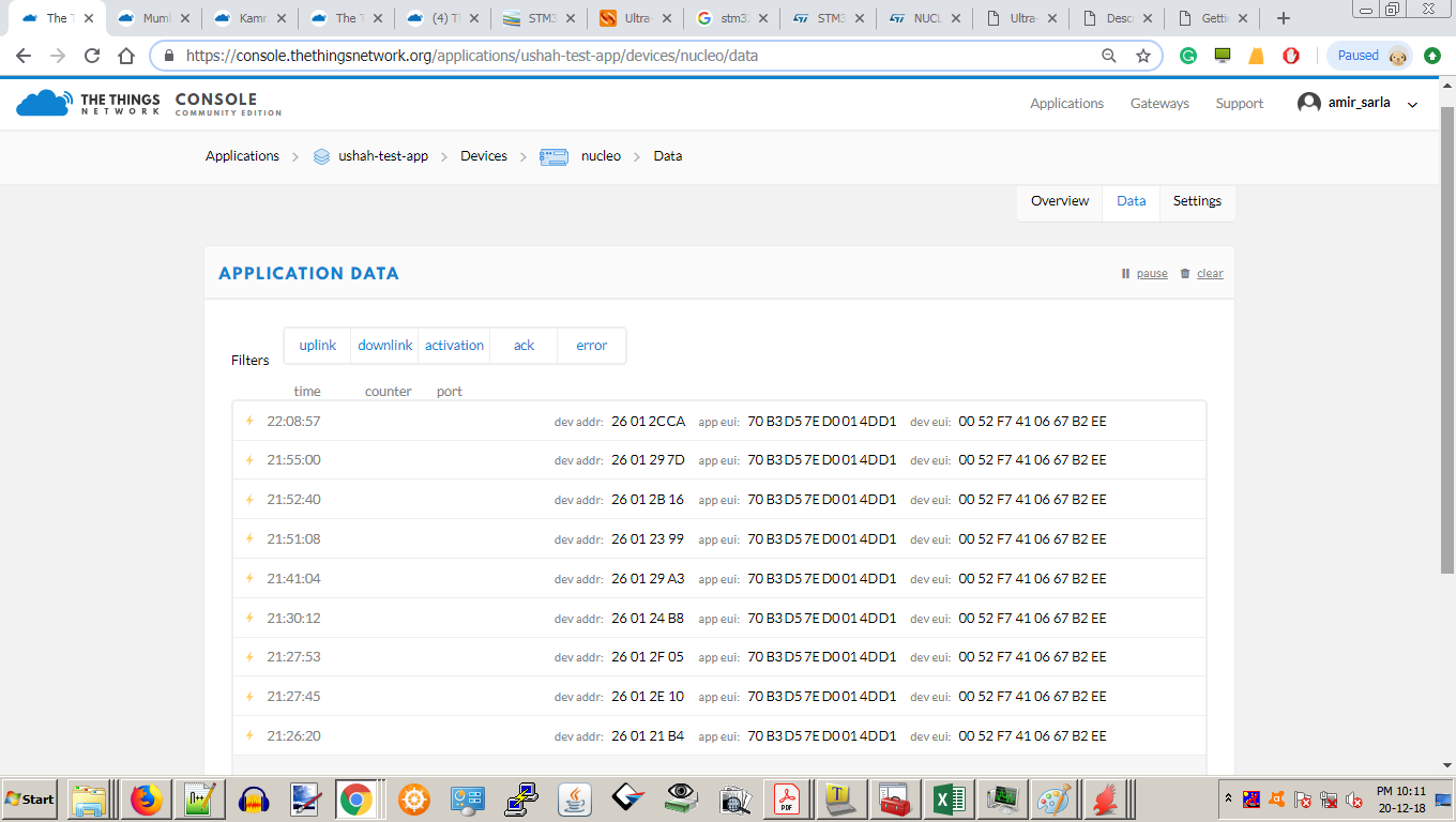

Activation This is what I see on TTN console.

the node send one join request and that is not answered, like Arjan said that’s not a full activation
Yes, its not fully activated.
So where is the issue. Is it a hardware issue or software.

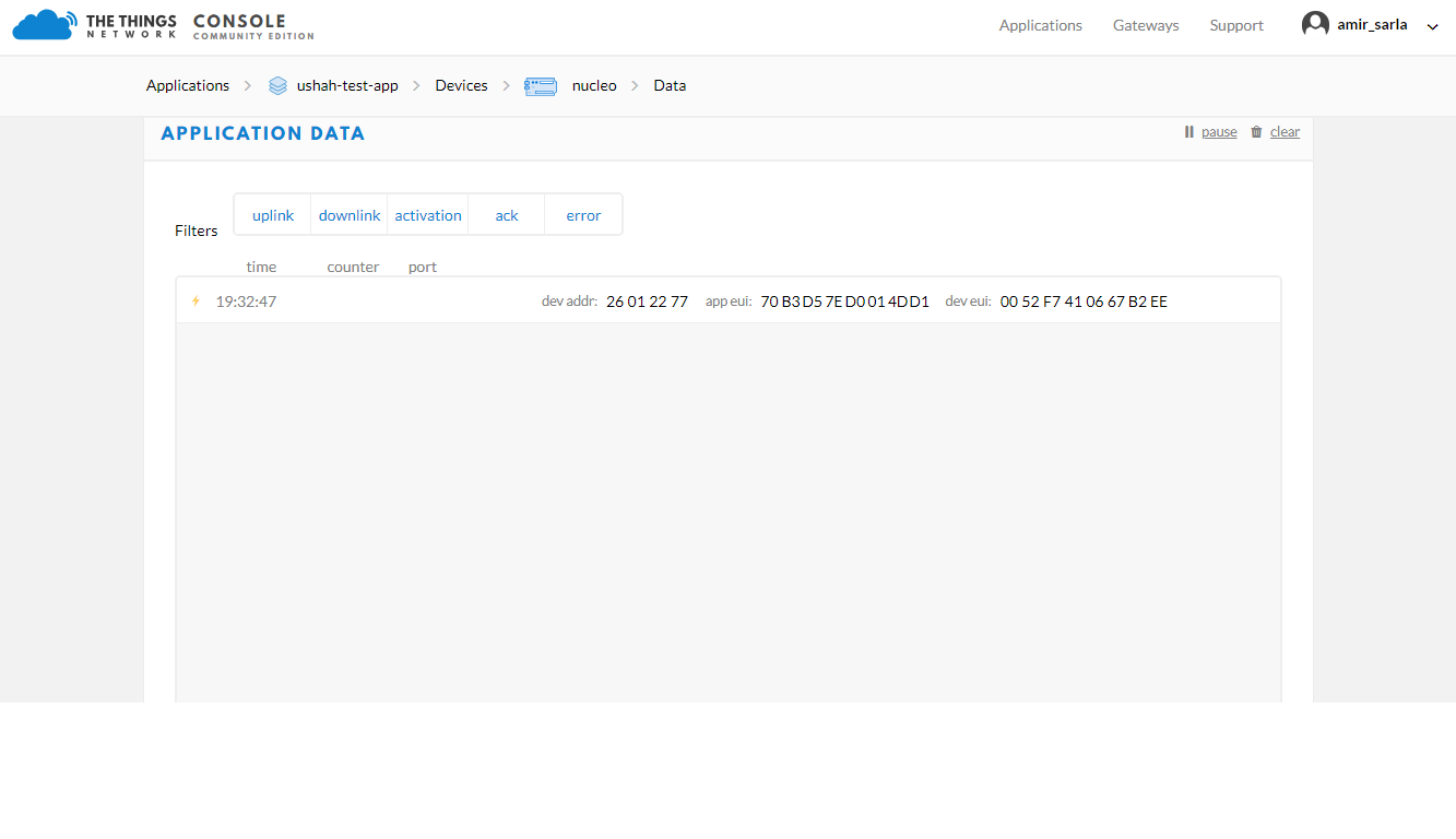

Activation3
Device is sending activation messages again and again but no response.

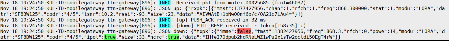

A debug of our gateway is shown below.mote_D0025685_fcnt_46037
We can clearly see the tx of an unknown device D0025685, starting with a fcnt of 46037) before getting activated.

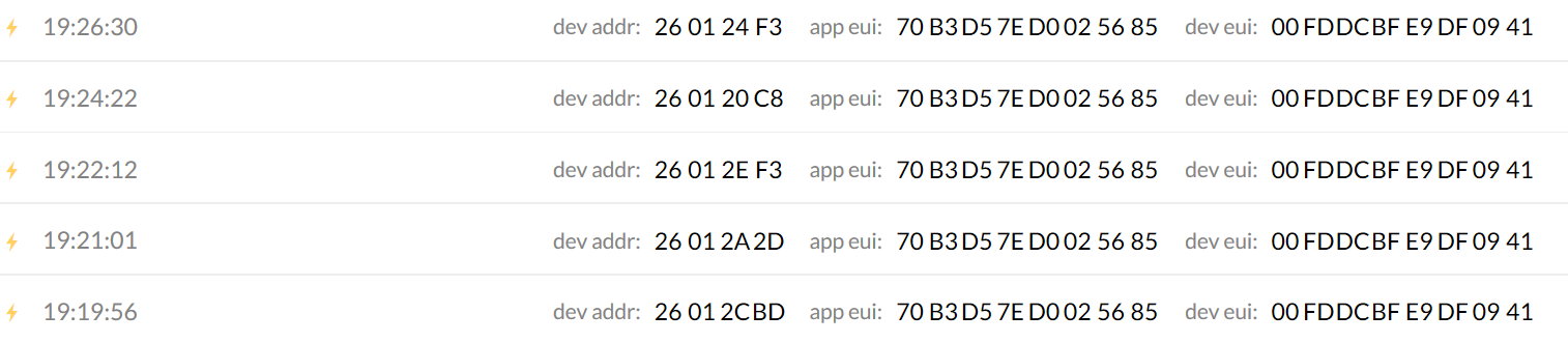

The real activation goes on and on, without any uplink of data as seen in the screenshot from the console over here:
activation_in_application

This morning still the same result : many activations without any uplink. The strange thing is the node transmits its join request as follows:
Nov 19 10:07:20 KUL-TD-mobilegateway ttn-gateway[896]: INFO: Received pkt from mote: D0025685 (fcnt=46037)
Nov 19 10:07:20 KUL-TD-mobilegateway ttn-gateway[896]: JSON up: {“rxpk”:[{“tmst”:2793609124,“chan”:0,“rfch”:1,“freq”:868.100000,“stat”:1,“modu”:“LORA”,“datr”:“SF9BW125”,“codr”:“4/5”,“lsnr”:7.8,“rssi”:-99,“size”:23,“data”:“AIVWAtB+1bNwQQnf6b/c/QB/3HFRDt0=”}]}

Are you really sure that the first line is your node?
It seems your gateway does not know how to decode a Join Request, and then shows a false frame counter and false DevAddr, assuming it was an uplink. In reality, AIVWAtB+1bNwQQnf6b/c/QB/3HFRDt0= is indeed a Join Request, for AppEUI 70B3D57ED0025685 and DevEUI 00FDDCBFE9DF0941.
(An OTAA Join Request does not include a frame counter, nor a DevAddr. Also, a D0025685 DevAddr is not a TTN device.)
There is a 5 or 6 seconds delay between a Join Request and the transmission of a Join Accept. While the details for a Join Accept might be forwarded to the gateway a bit earlier than the scheduled transmission time, there’s usually really a few seconds delay after the request, which is not shown in the above screenshot of the 19:24:50 logs. I’m not sure if that means something. I guess the last line is indeed the Join Accept for the first line. If it does not match the output in TTN Console, then you could paste the “data” in the online decoder to check.
