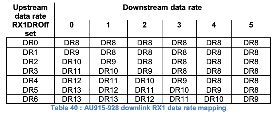

Isn’t that covered in, e.g., LoRaWAN 1.0.3 Regional Parameters?
AU915- 928 Receive windows
  • The RX1 receive channel is a function of the upstream channel used to initiate the data exchange. The RX1 receive channel can be determined as follows.
    • RX1 Channel Number = Transmit Channel Number modulo 8
  • The RX1 window data rate depends on the transmit data rate (see Table 17 below).
  • The RX2 (second receive window) settings uses a fixed data rate and frequency. Default parameters are 923.3Mhz / DR8
