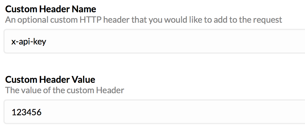

Okay, well for the time being, I’m using an AWS API Key to marshal API access. That just requires generating a key, and then adding a header of the form “x-api-key”: to the request. I’m thinking that because these motes’ interaction with the API would be short-lived, it would be simpler to skip token exchange altogether, and just use a static key. Curious to know your thoughts.
That works as well, by specifying a custom header when configuring the HTTP integration.

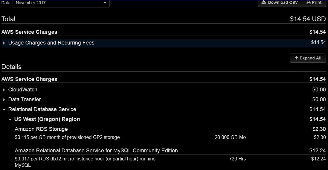

Nice! On AWS, I had an RDS instance on the “Free Tier” that was never used, and was charged $15 a month. Would love cheaper cloud solutions.
This integration may run for free in your AWS account, depending on what else you have running and on the number of messages.
The integration can run as a t2.micro instance (one is free per account) and smaller LoRaWAN deployments may fall well within the free tier limits of AWS IoT, see https://aws.amazon.com/iot-core/pricing/
Though they claimed it was on the “Free” tier, my t2.micro was definitely not free.
Are you sure you were still in your first 12 months?
No, I am not still in the 12-month trial. “Free” just applies to the trial period?
RDS t2.micro is something different than EC2 t2.micro I guess. Anyway let’s get on topic again
