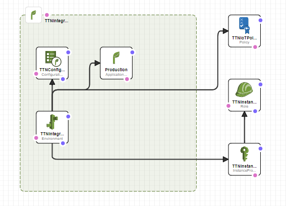

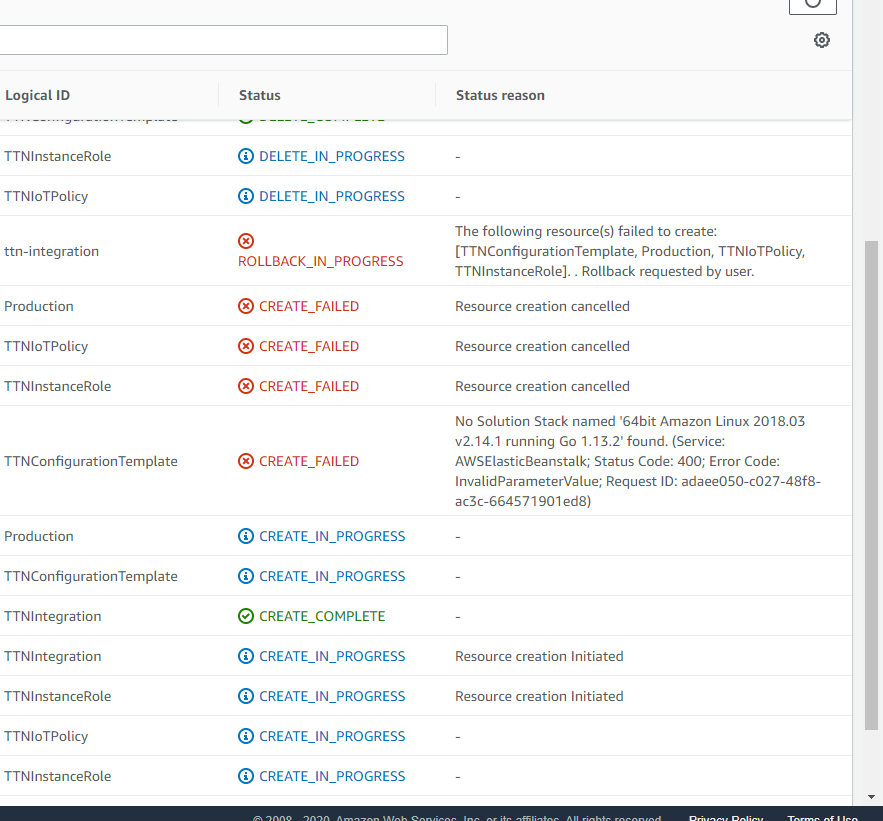

Hi, I am getting this error too when trying to integrate with AWS IoT. I checked all the instances running and the one in TTN’s configuration template isn’t one of them as a newer version is now being run of Amazon Linux and Go. here is a screenshot.
What I did was download the CF Template locally and changed the parameters to match the supported Go version on AWS, check the following to get the version:
Then edit the line : SolutionStackName: 64bit Amazon Linux 2018.03 v2.14.1 running Go 1.13.2
on the JSON CF Template file.
On AWS for Elastic Beanstalk , create a new stack with the upload from file option and upload the edited file.

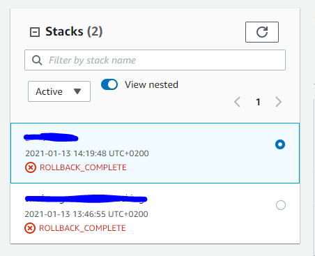

Thanks I have tried you method but it fails, I have also created a new AWS account and it still fails.

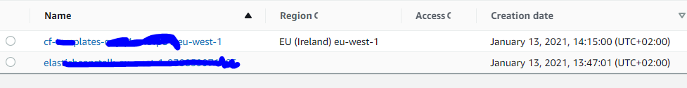

I see the S3 buckets gets created every time.
