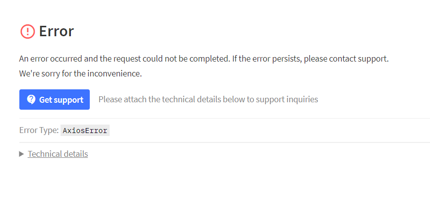

Axios Error while trying to view device details on TTN web console
Need help with this error:
An error occurred and the request could not be completed. If the error persists, please contact support.
We’re sorry for the inconvenience.
Error Type: AxiosError
  "message": "timeout of 10000ms exceeded",

I have the same error too. I tried to view the device details and encountered AxiosError.
I couldn’t register new end devices as well.
I have also similar case, then now unable to explore end device, with this error type:AxiosError
The technical detail as bellow
  "name": "AxiosError",
  "stack": "AxiosError: timeout of 10000ms exceeded\n    at u.ontimeout (https://assets.cloud.thethings.network/console.4a399eda2365b7b8e6de.js:2:915342)\n    at Oe.request (https://assets.cloud.thethings.network/console.4a399eda2365b7b8e6de.js:2:920092)",
