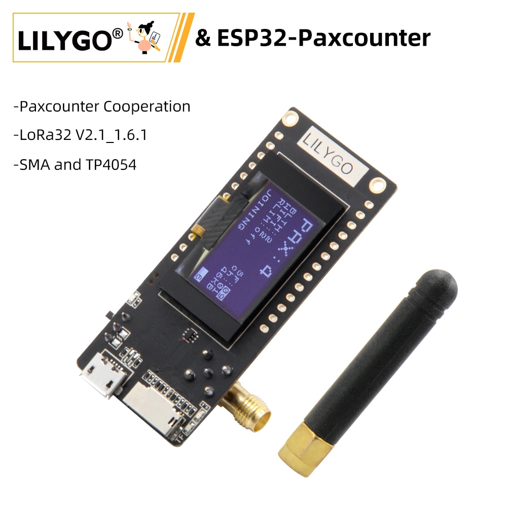

So go for an ESP32 based like TTGO that can run a web server (for http), be a web client (for http) or even MQTT. They have an SMA connector so you can mount a modest antenna outside to help with the range.
Use LMIC-node for the LoRaWAN part of the firmware.

I gonna buy from this thread. There is a list of supported devices.
LILYGO TTGO LORA32 868MHZ ESP32 0.96 OLED V2.1_1.6 PAXCOUNTER
Is one of this enough for my Plan?

But IT seems Like Its ttn compatbel, im gonna buy this
There are Tutorials how to connecte to ttn and use the 868mhz. Just need an extra Power supply.
