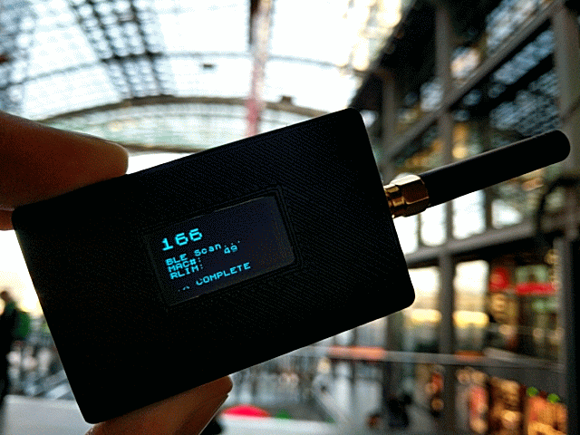

I’m working on reducing power consumption by modification of the software. Since i use the Wifi monitor mode continuosly for my application, power consumption is high. In this mode the Wifi modem is running all the time and consumes by far the most energy, around 100mA.
Consumption of the complete unit, including display and LoRaWAN transmit (in test version a few bytes all 240 seconds, what probably is beyond TTN policy) is actually ~680mW.
In the small case i’m using a 3,7V/500mAh Li Ion cell, so has 1,85Wh. In this configuration the unit should run 2-3 hours on battery.
Far away from a low power application, but Wifi MAC sniffing never is a low power application. My goal is to bring the unit below 500mW and i will add a 18650 cell, then it should run around 15 hours on battery - enough to track a full daylight day.

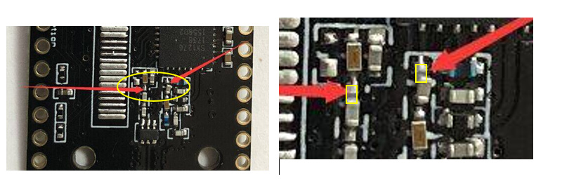

The rang issue can be solved.

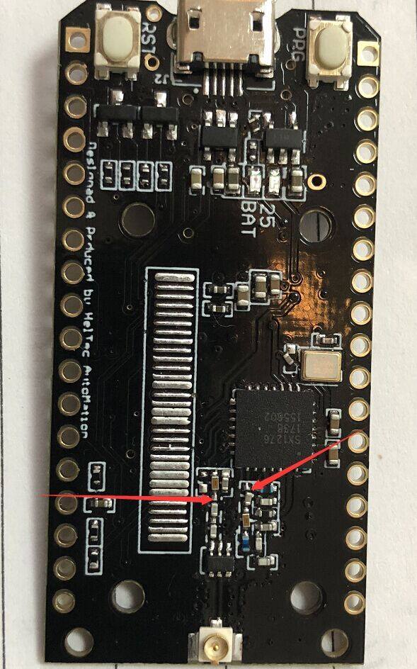

The LILIGO seller contacted us abot this . There was a factory issue (see red arrows)
it you take care not to damage the display you can solve the range issue yourself
So it’s a soldering problem where the two red arrows are?
If you are looking to add GPS to the ESP32 LoRa boards, this might help; I posted this last night - https://www.thethingsnetwork.org/labs/story/heltec-lorawan-gps-quick-start
This board looks like the smd components would have been placed manually, by hand.
Poor quality. But is also labelled “Heltec Automation”. The question ist, who designed the original, and where is a reliable source for originals? Seems to be the typical problem when sourcing from China?
@ccadic - I don’t quite understand - what is the issue? trace missing? bad soldering? I think I can see the same thing on my board, but not sure what the issue is, so don’t know what the solution is
Take a closer look at the placements of some smd parts on the pcb.
Got it… so we need to get those two components attached properly - so dab of solder where the the yellow boxes are in my photo? (right?)
Someone else mentioned a problem with C22? Is this the same thing? (this looks like 2 problems, not just the one mentioned by David in the facebook group!)
The capacitor (or resistor?) near the 26 MHz crystal looks weird, too.
The whole pcb is of poor quality, this is not industrial quality level. I wouldn’t waste time trying to use it. But where to get better ones?

Will have a look if the resistors on my module are misplaced… If so have to get a steady hand for resoldering.
