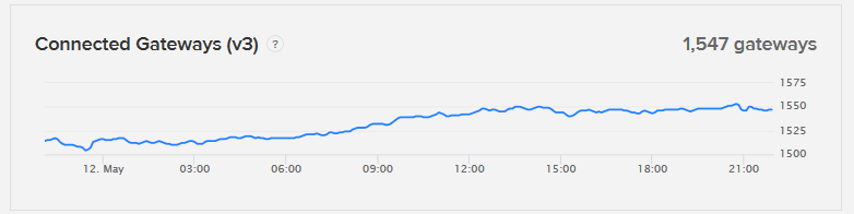

1,547 gateways currently connected to v3: https://status.thethings.network

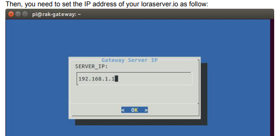

How do you imagine your Pi knows what to do with all these radio signals being received? You can type anything you like in to the console, but if you don’t tell the gateway where to send its information, there’s no link to TTN.
Duh, I may have missed this - is this the part of the setup that I need to look at (see pic. below)?
What would be the IP address of the TTN V3 server?
There was a setup screen that allowed you to setup “server is TTN” and I assumed that it obtained the connection information from there.
Another assumption was that the following screen was for self hosted servers…
Capture
That’s you installing the ChirpStack which is not what you are aiming for.

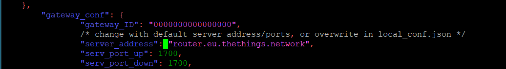

I have edited the file global_conf.json found here in the RAK gateway O/S
/opt/ttn-gateway/packet_forwarder/lora_pkt_fwd/global_conf.json
with the correct address. The edited file is shown below:
Capture
Are the port addresses correct?
(I have replaced all the zeros shown in the Gateway ID with the correct value from the overview field in the TTN V3 console)

I’m confused. You post the address as show in the v3 console and then type something different in to the global_conf.json so it’s sending data to the wrong server and there’s a question about not showing connected in v3!!!
