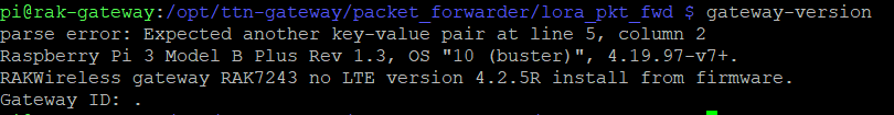

Also, since enabling wlan0, I see that running gateway-config on the pi no longer announces the MAC address at the top of the menu as the Gateway ID:
menu
I assume that Gateway ID = Gatway EUI, ie an 8 byte number? (at least this is what the software populated the menu with on initial setup)
Ditto running the gateway-version command. The Gateway ID on the pi is absent. So I maybe I have corrupted something. However, global_config.json and local_config.json match the settings in the overview section of the gateway in the browser.

Regrettably no. I can’t see what I am doing wrong, but as I mentioned, the rack menu application and gateway-version command doesn’t return a Gateway ID (Gateway EUI)
gaeway-version
Jimgi
Looks like you modified a file the RAK software depends on. I would take a fresh SDcard (so you can keep the current information and get back to it if required), flash it with a clean image and start over.

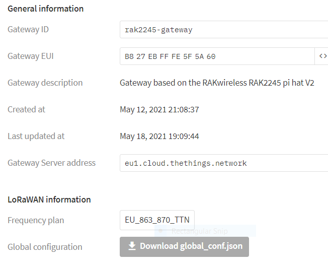

Right, now I’m curious what you entered in the V3 console. Could you post a screenshot without completely obscured EUI and ID? (Just obscure the last 4 digits if you need to)
I’ve lost track, what can we do if we know someones gateway EUI - because I can harvest them from my uplink meta data so it can’t all be top secret?
Just to confirm, the Gateway ID is the Gateway EUI field in the v3 console. And the RAK autogenerated id isn’t anything special to the hardware as such.
Minor butt, but when I put my PiSupply RAK833 on to v3 there was some uncertainty about what was or wasn’t working so I downloaded some handy packet forwarding software, compiled et voila. It is still lurking under the rubble on the desk so I can try stuff tomorrow.
OK, here is a screenshot of my Overview page:
Config
The Gateway EUI is straight out of the pi application. The Gateway ID and description are just text strings that I supplied. Not derived from anything.
jimgi
And that same string minus spaces is in the global_conf.json and local_conf.json?
If not, replace the EUI with the value in the json files.
If they match, please post the log of the packet forwarder, the lines from startup of the forwarder up till the second repeating status block.

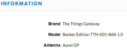

I have a TTN gateway on that works in the same location, and connected to the same Virgin Media hub.
TTN_gateway
Yes, it is V2.
So must be the image…
