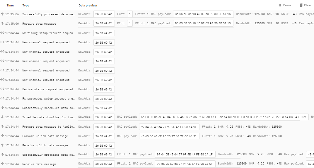

When I program the STM32 I get some weird behaviour. At first the packets are received by my BasicStation gateway and forwarded to the application in TTN. However, every uplink that is received triggers a downlink:
I assume the repeated downlinks mean that the node is not reacting to the MAC packets correctly, causing the network to send them again, but I’m not sure.

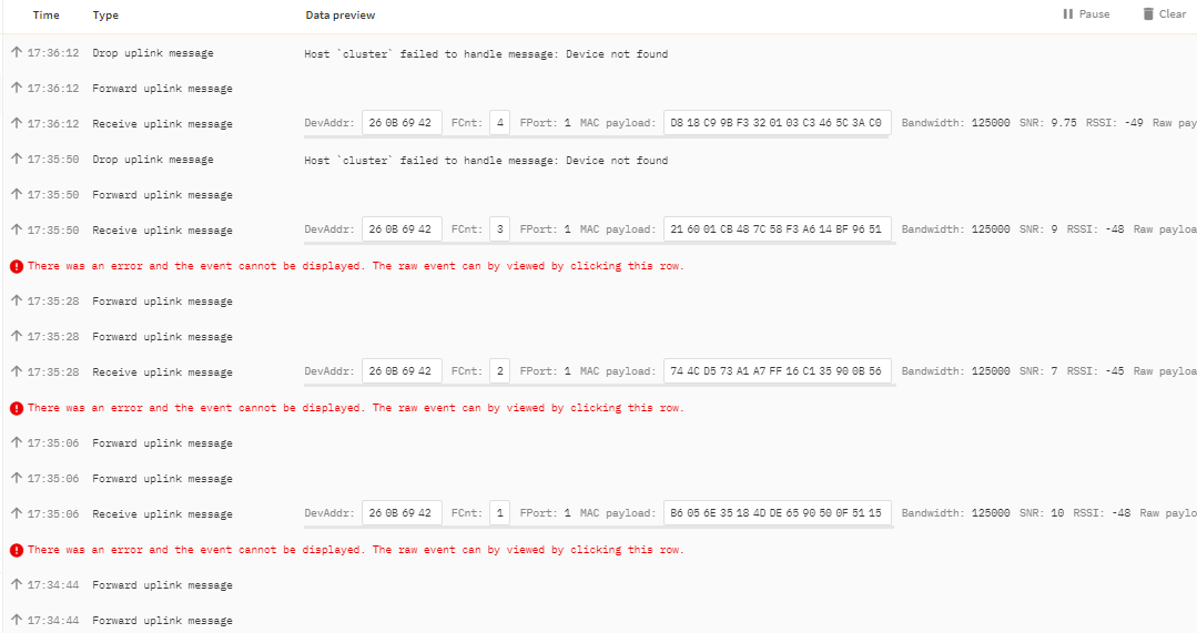

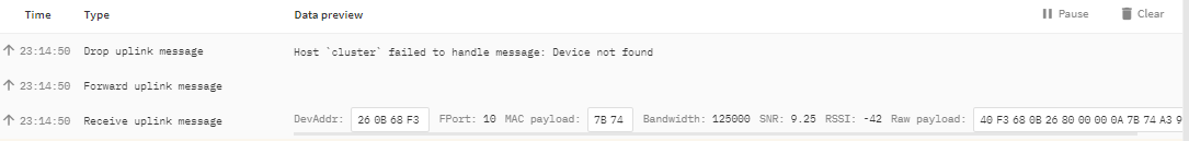

After the first few uplinks the packets stop reaching the application with an error message Host `cluster` failed to handle message: Device not found on the live gateway data page:
The device not found errors looks like this:

We can also see that for every packet that did reach the application, a mysterious red error was triggered. When I click on one I see this:

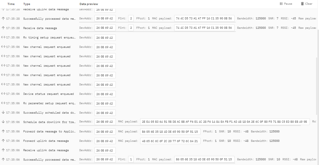

The BasicStation console shows that for the first few uplinks (the ones that reached the application) a downlink was sent in response, but afterwards no downlinks were sent:

My interpretation is that there seems to be two issues:
- Some uplinks are dropped before they reach the application
- All of the uplinks that do reach the application trigger a downlink, which is not sustainable
